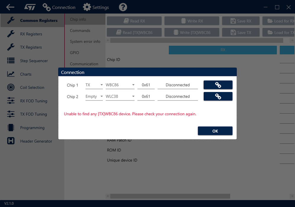

  • GUI Error message with STWBC86 evaluation board:
"Unable to find any [TX]WBC86 device. Please check your connection again."
STWBC86 GUI connection issueSTWBC86 GUI connection issue
  • GUI Error message with STWLC38 evaluation board:
"Unable to find any [RX]WLC38 device. Please check your connection again."
STWLC38 GUI connection issueSTWLC38 GUI connection issue

I tested the GUI on another Windows 11 laptop, and I still have the same issue with version 2.1.0. It cannot connect to the board and show the error message.
Did ST try the STSW-WPSTUDIO software on a Windows 11 PC ? Or does the GUI only work on Windows 10 ?
Connection ERROR againConnection ERROR again

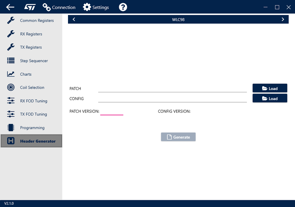

I confirm there is NO LOG menu on this version of the GUI. The last menu line that I can see is "Header Generator".
No Log menu visibleNo Log menu visible

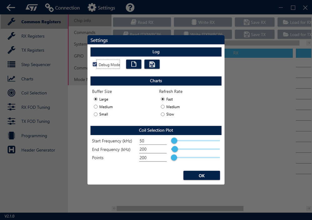

I saw in the SETTINGS menu, there is a "Debug Mode" that we can enable.
But even enabled, I still don't see any LOG menu appearing on the main interface.
How did you enable the LOG menu ?
Debug mode enabled doesn't change anythingDebug mode enabled doesn't change anything

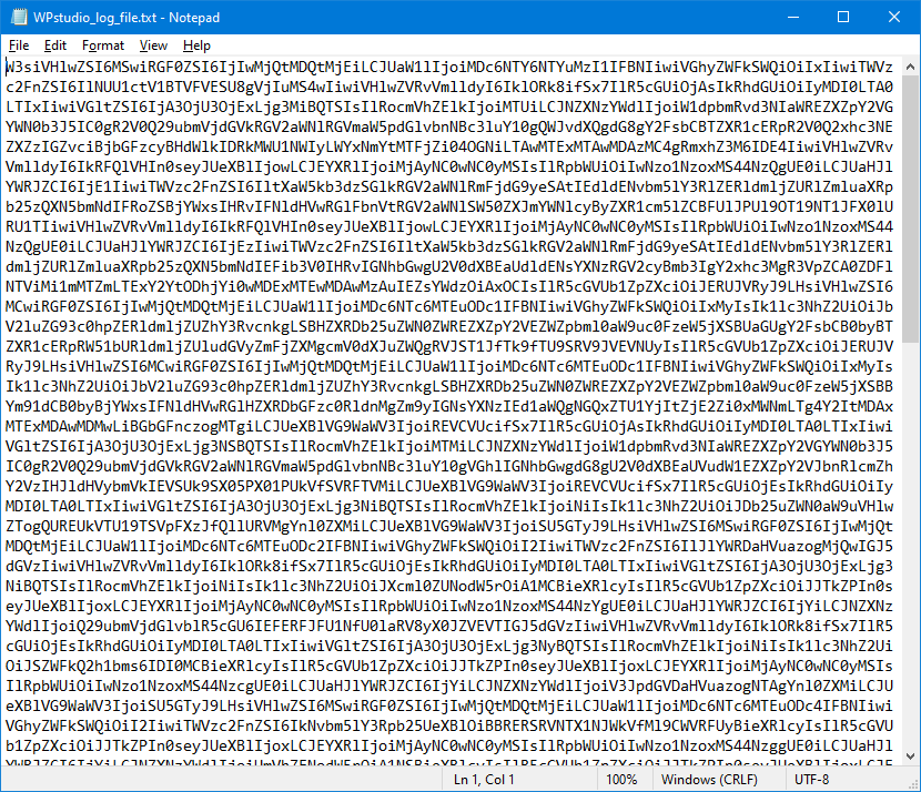

I tried to click the save button: "save current log to text file". But the log file recorded is meaningless because it is just binary data !!
How can I find out by myself what is the software issue if everything is kept in binary format by ST ??
log file is unreadablelog file is unreadable

{"Type":1,"Date":"2024-04-22","Time":"10:11:35.741 AM","ThreadId":"6","Message":"McpDongle enumerate in 2ms","TypeToView":"INFO"},
{"Type":2,"Date":"2024-04-22","Time":"10:11:35.742 AM","ThreadId":"6","Message":"FT260 Dongle Library Load error ","TypeToView":"WARNING"},
{"Type":1,"Date":"2024-04-22","Time":"10:11:35.742 AM","ThreadId":"6","Message":"FT260 enumerate in 1ms","TypeToView":"INFO"}]

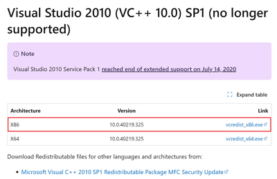

We have confirmed this version GUI is dependent on “Microsoft Visual C++ 2010 X86 Redistributable Package” .
GRB
A 14 year old Service Patch, why didn't I think of that?
Hi
This is due to FT260 dongle dll file need this Microsoft Visual C++ 2010 driver.
