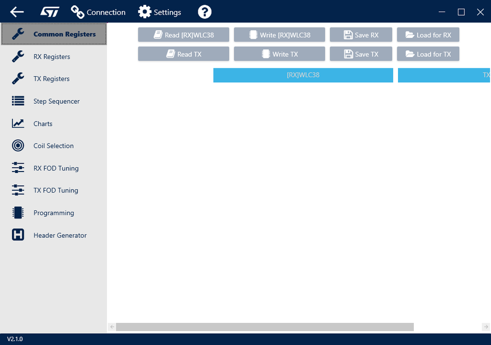

2024-04-16 12:32 AM - edited 2024-04-16 12:37 AM
Hello Sir,
I tested WPSTUDIO version 2.1.0, but there is no LOG available in this version !!
So how are we supposed to see the full error messages ?
STSW-WPSTUDIO_v2.1.0 still buggy
And I don't see any release notes for the software you provided.
So which bugs are fixed in v2.1.0 ? Is it supposed to fix the USB connection issue ?

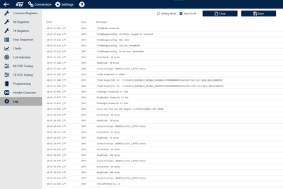

2024-04-19 9:00 AM
I am also having the same problem, tried on two different computers and versions 2.1.0 and 2.2.5.
The error in the log file is:
,{"Type":3,"Date":"2024-04-19","Time":"04:34:11.573 PM","ThreadId":"9","Message":"Error during enumeration for HidDongleMaster: Unable to load DLL 'HidDongle.dll': The specified module could not be found. (Exception from HRESULT: 0x8007007E)","TypeToView":"ERROR"},

2024-04-20 5:53 AM
It seem your computer can not load this dongle driver, please google ft260 driver to install again.
