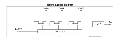

According to the functional block diagram in the datasheet, the sources of the MOSFETs are not connected to any current sensing circuitry.
Is the “I-REG” block used for generating a PWM signal, or is it for other types of control based on feedback from the current?
If it is PWM based, how can I calculate the PWM frequency? Specifically, I want to understand how the turn on time is determined and when it occurs if the control is indeed PWM-based. Because at the same particular turn on time only, i will have to take the reading from receiver.
So, how it is maintaining the constant current?
As already mentioned, the current per output channel is regulated linearly. Figure 2 from the data sheet only shows the output stages schematically; in reality, each of the channels is a constant current source, not PWM based.

I forgot to mention how the linear power sources are implemented: without going into too much detail, I would just like to mention the term current mirror.
