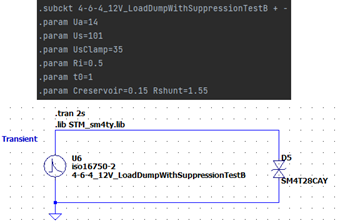

2) In Load Dump with Suppression Test B, the current and voltage of the electro-thermal model and the basic model of TVS diodes were compared.
a) Basic model of SM4T28CAY
According to the simulation results using the basic model,
VTVS is nearly constant,
and ITVS is thought to be determined by VTVS, the diode voltage in the IV-curve.
And, actually, too much power dissipation occurs at the SM4T28CAY.WonnyPa_4-1757658966883.pngWonnyPa_5-1757658981687.png

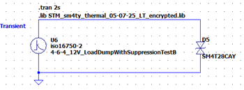

b) Electro-thermal model of SM4T28CAY
According to the simulation results using the electro-thermal model,
the section where VTVS is constant has become longer,
and it seems difficult to match the ITVS to the VTVS in the IV characteristic curve.
Q4) The ITVS initially has a large current flow. What characteristics of the TVS determine this value?
Q5) The ITVS decreases rapidly even when VTVS is constant. What is the reason for this?
