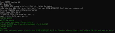

Managed to get it working again by glitching the i2c pin as the program tries to read the config id / patch id over the bus. Flashed the stock firmware for both patch and config after that.
We accidentally flashed (Few Times Programmable) an STWLC38 with the nvpatch of an SWBC86. The chip is now non-functional, but still appears at 0x61 on the i2c bus. The WPC Studio won't connect to it as Empty or RX.
Anyone have any ideas how flash it again?

please use command line for wlc38
@Echo off
REM use tool and command line to down fw to chip
set memh_patch="STSW-WLC38FWEPP\STEVAL-WLC38RX_nvmpatch_1437.memh"
set memh_cfg="STSW-WLC38FWEPP\STEVAL-WLC38RX_config_1F46_EPP.memh"
"STSW-WPSTUDIO V2.2.5.exe" fw -d WLC38 -p %memh_patch% -c %memh_cfg%
pause

HI
Sorry i am not very clear, please check this attach file.
