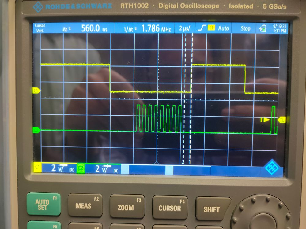

To validate the drive L6474PD I was reading the status through getStatus command but the drive is responding with FFFF. I am not understanding to validate the drive through SPI.

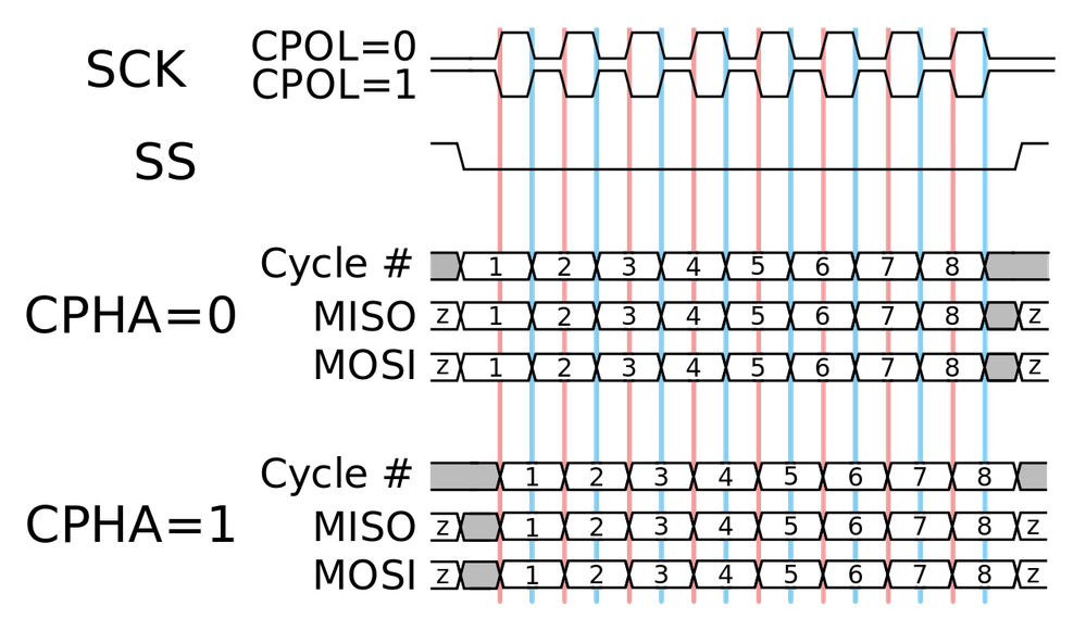

If you do not configure the proper clock polarity and phase the communication fails.
You must set CPOL = 1 as above mentioned and CPHA = 1 (the IC updates the out on the falling edge and samples on the rising edge).
I attach a picture of SPI timing diagram [from wikipedia]:
Let me know if with the proper setting solves your problem.

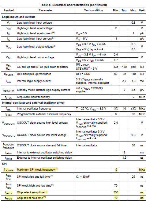

Attaching below the L6474 datasheet page in which it is confusing what is maximum speed of SPI
‎2021-09-09 06:48 AM

To better understand, could you share the SPI timing diagram of a command (e.g. GetStatus)?
‎2021-09-15 01:20 AM
Hi @Cristiana SCARAMEL​

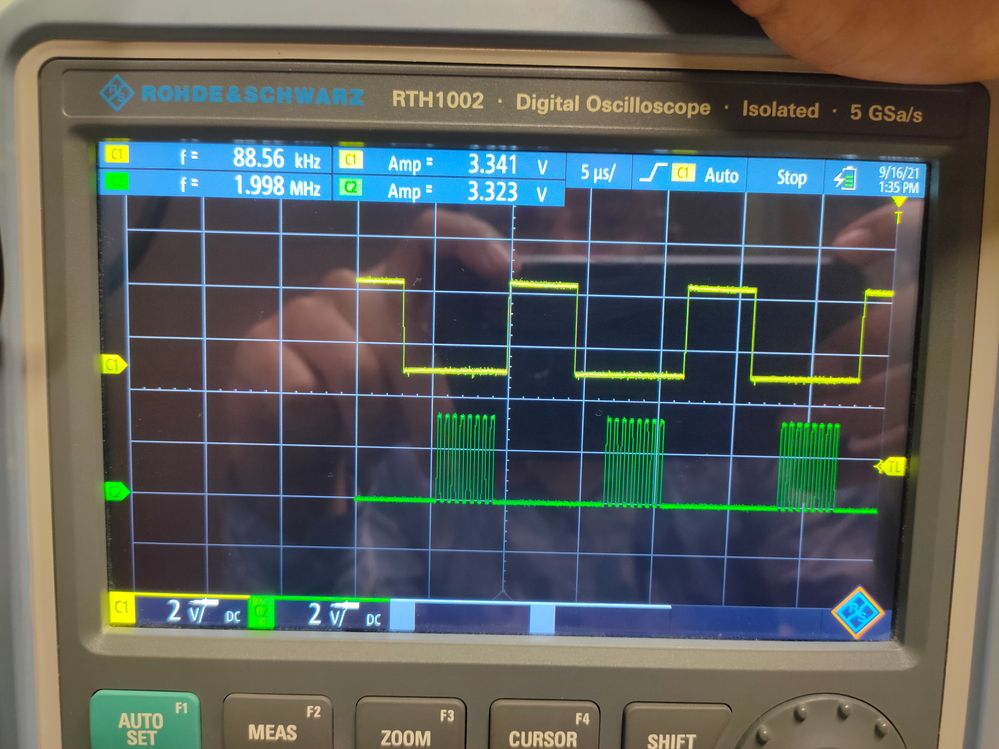

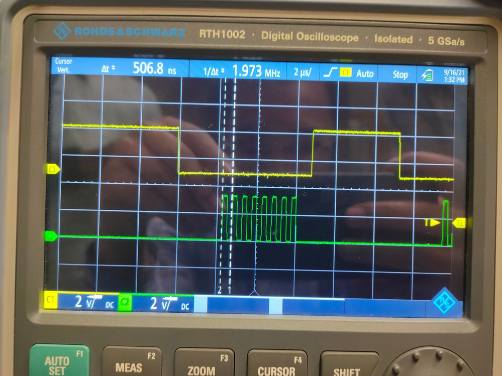

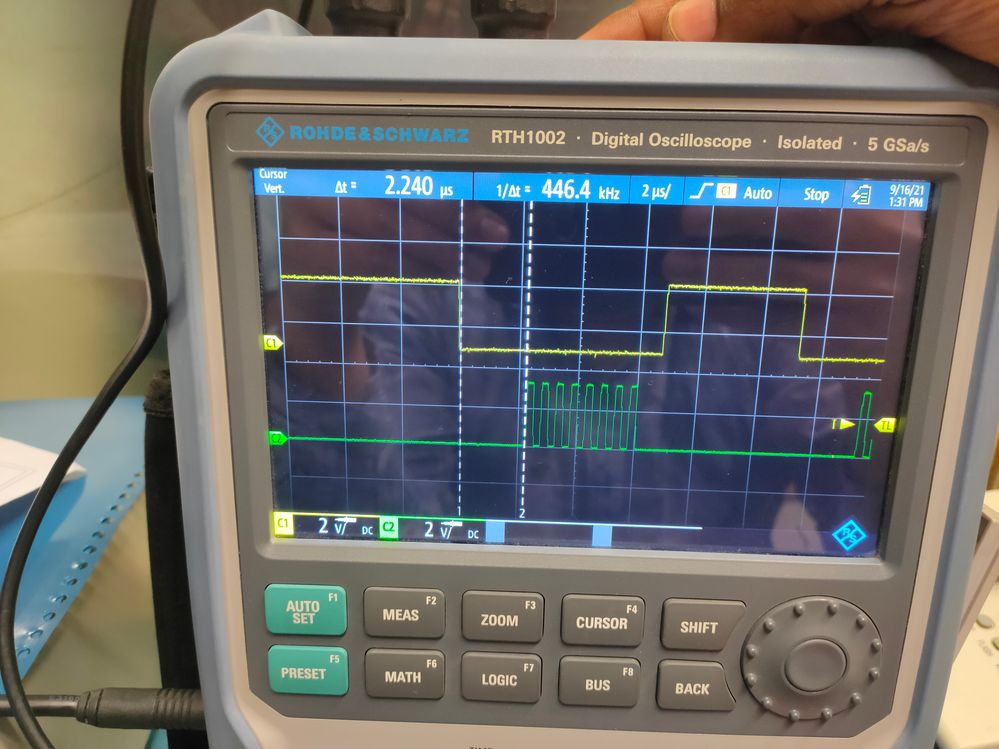

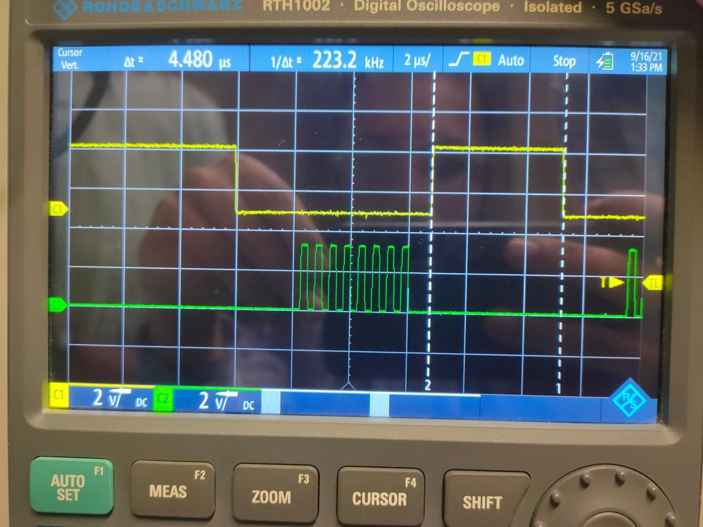

Attaching screenshot of waveforms for reading status please go through.
‎2021-09-15 08:20 AM
Hi @Community member​,
in your screenshot CS signal (yellow) and CK signal (green trace) you are using clock polarity CPOL = 0.
In the L6474 datasheet the SPI timings diagram (Figure 13) show a CPOL = 1 (a clock which idles at 1, and each cycle consists of a pulse of 0).
Let me know if this solve your problem.
