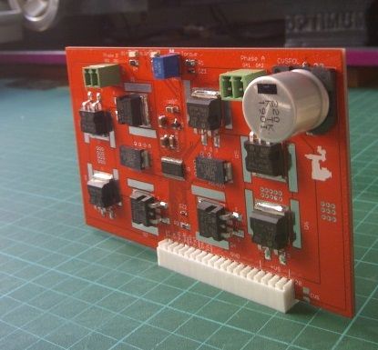

I have designed a board using a L6482 chip.
My L6482 has started, and I can send and receive messages a través de SPI bus, but now I have a problem:
My STATUS register says:
1110 0000 0000 0011
  (Get Status Command = 0xE003).
It means:
OCD
= 1  --> overcurrent
BUSY
= 1  --> Stopped
Hiz
= 1  --> Bridges in High Impedance State.
The problem occurs
even
without connecting the
stepper
motor.
Just turn on the power, and my L6482 gets quite hot, but I have measured the total current of the board, and it is only 0.1 Amp.

I have found the solution of one of my (small) problems
In my board, some voltages were wrong:
VCCREG = 6,86 -- 6,97v
VREG = 4,62v
I had forgotten
to put the condenser
CVREG=22uF
Now all voltages are exactly equals to voltages checked on the EVAL6482H board.

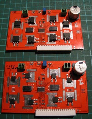

Afterwards, I have mounted two boards, for comparing their behaviors:
  • One board with
    STD25NF10T4
    Mosfets, Vg=15v, (DPAK), as EVAL6482H board.
  • One board with
    STB80NF10T4 Mosfets
    , Vg=15v, (D2PAK, a bigger mosfet).
I have made several tests, and:
1) Board equivalent to EVAL6482H runs with 1Nm motor connected.
(BSY flag
is
successfully activated
, motor runs, and FLG is not activated).
(Led yellow On, Led Red Off)
2) Board with
STB80NF10T4 Mosfets
runs fine when there is not any motor connected.
(BSY flag
is
, and FLG is not activated, Led yellow On, Led Red Off).
But when I connect a PaP motor and I send a Move command, FLG signal is activated.
(Led yellow Off, Led Red On)
Then GetStatus() returns this
Error: 0x00000603
Overcurrent event is right away activated, but there is no reason for this happen. What is happening?

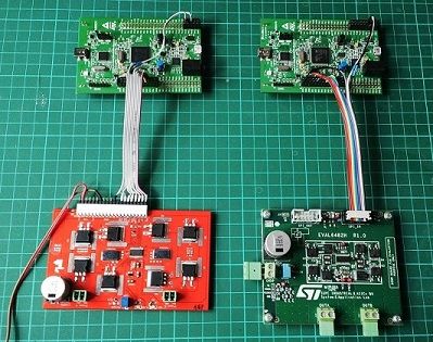

Posted on June 23, 2014 at 18:12
As is shown in this image, the
test
environment
is very simple: Two STM32F4 DISCOVERY boards, connected to this PCB boards. However, the results
are totally different.
I ask to ST the same question once again:
Is L6482H able to drive bigger Mosfets than STD25NF10T4 model?
Has this situation
ever
been tested
by ST?
Maybe I should stop trying to control these MOSFET, and use these smaller STD25NF10T4  Mostfet....

val_ltd
Posted on June 24, 2014 at 19:44
My board with
STB80NF10T4 Mosfets, Vg=15v, (D2PAK, a bigger mosfet).
started to run, when I have modified the next parameters, and I have put very low values.
    CSPIN_SetParam(CSPIN_TVAL_HOLD, 0x08);
     CSPIN_SetParam(CSPIN_TVAL_RUN, 0x05);
    CSPIN_SetParam(CSPIN_TVAL_ACC, 0x05);
    CSPIN_SetParam(CSPIN_TVAL_DEC, 0x05);
In board with:
STB75NF75L   (D2PAK) Mosfets, and Vccreg= 7,5v
I have reduced gate current = 64mA to 32mA and a longer TCC value, and then board started to work,
Movement is not perfect and some times the test secuence of movements stops suddenly and unexpectedly.
