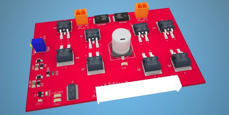

I have designed a board using a L6482 chip.
My L6482 has started, and I can send and receive messages a través de SPI bus, but now I have a problem:
My STATUS register says:
1110 0000 0000 0011
  (Get Status Command = 0xE003).

larken
Posted on June 28, 2014 at 19:45
Ramirez, the problems you are having are most likly your PCB layout. Having your mosfet place around the board with the control chip in the middle will cause al kinds of stray current arround it affecting the operation.  Yours may look like the eval board, but they may have a hidden layer just for the high currents. Also your main capacitor and incomming power is off to the corner far away from the other bridge, so the path lengths are different.
 I suggest to put the bridge and input power on one side of the pcb, with a common ground and power point exactly center between the 2 bridges. Your 2 sense resistors should connect there and the main cap and bypass cap (.47uf 100v poly) should be all there in a tight close power point between the 2 bridges.
 Then beside the  power section put the control L6482 with a thick ground pad going over to the star gound point where the power and sense res connect. Thats the only place where all grounds come from for all inputs and power.
 You can actualy get good results from a 2 layer properly layed out hand routed pcb, than a poorly layed out 4 layer.

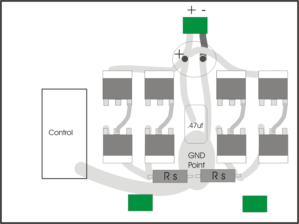

larken
Posted on July 01, 2014 at 00:44
Here is a mockup of a layout used in some commercial drives.  Also you could put an on board fuse to protect the motor, incase all else fails.

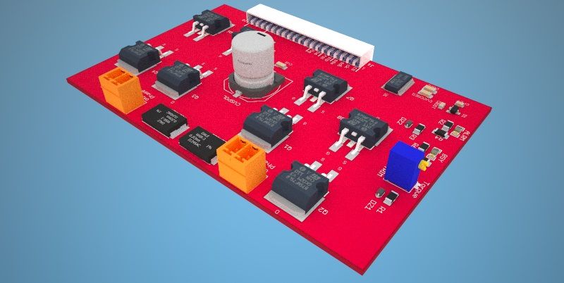

val_ltd
Posted on July 01, 2014 at 08:18
Thank so much , Kenny for your support,
I think your proposal could be something like this:

Posted on July 04, 2014 at 22:31
You may want to put the l6472 on the on the bottom side closer to the sense resistors so the paths are shorter.  Its important the control chip be close to the sense resistors and that common ground point.
You might be able to make the bridges area more compact so the power traces are shorter. The smaller pcb real estate in the power section, the less noise it will generate.
Also adding opto couplers for the Step and Direction inputs makes sure there are no ground problems when connecting to the control board.
