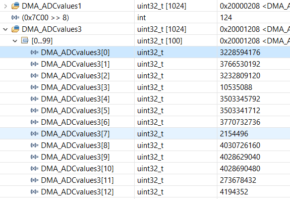

I am seeing very noisy measurements on shunt adc.
I attached schematics and gerbers.
Could suggest how to eliminate noise on adc lines (line connected to shunt and going to STM32F303 chip?

ADC values are here, but it is funny how they difference of one measurement to another is quite big - could it be that they are indeed correct or possible, or it is some flaw in my program?
I am using:
hadc3.Init.Resolution = ADC_RESOLUTION_12B;
and
sConfig.SamplingTime = ADC_SAMPLETIME_2CYCLES_5;
Should I use half word, or word in dma alignment?
hdma_adc3.Init.PeriphDataAlignment = DMA_PDATAALIGN_WORD;
Posted on November 26, 2017 at 02:04
OK found the mistake... I was using,
hadc1.Init.DataAlign = ADC_DATAALIGN_LEFT;
instead
hadc1.Init.DataAlign = ADC_DATAALIGN_RIGHT;
Also I found out that using:
        hdma_adc1.Init.MemDataAlignment = DMA_PDATAALIGN_HALFWORD;
is OK.
Now I got reasonable results, thanks for all help, there is a code under git link I post above - maybe it helps somebody.
