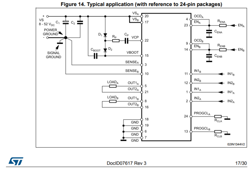

I am seeing very noisy measurements on shunt adc.
I attached schematics and gerbers.
Could suggest how to eliminate noise on adc lines (line connected to shunt and going to STM32F303 chip?

I see you have a strong low-pass filter between shunt and ADC input (cut freq of about 1.5k if I'm not wrong).
This could filter too much your sensing!
The current flows into the shunt only when one high side and one low side are on, so the voltage on the shunt is very discontinuous. If the cur frequency of the filter is lower than the PWM frequency you are using you kill the signal.
So, my suggestions are:
  1. Synchronize the ADC reading with the PWM in order to catch the value only when the current is actually flowing into the shunt.
  2. Increase the cut freq of the filter above the PWM frequency

Also another idea - could it be that I am experiecing ground noise? From datasheet it seems shunt resistor should have very short ground path - see picture from datasheet? Please comment.

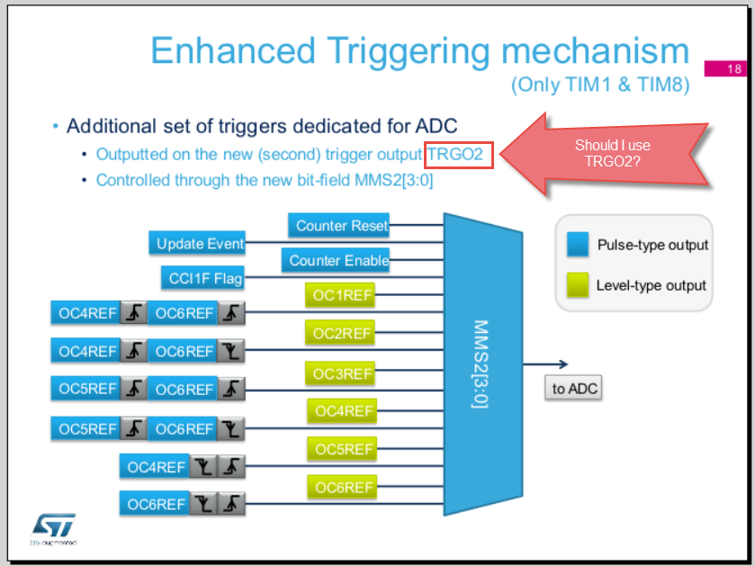

For synchronize the ADC conversion with the PWM generation you can set the TRGO signal of the timer to be generated by the 'update' event and then set the ADC to start the conversion according to this signal.
In this way, if you are using the center-aligned pulse generation, you will have a conversion event in the middle of both the ON time and OFF time of the PWM.
The conversion during the ON time can be used to sense the current and the other one is ... at your disposal
Ground noise generated by long sense paths is an high freq noise generated by commutation by inductive effects. If you sync in the middle of the ON time as described, you will sense the current far away from the peaks.

The trigger event you should use is the TIM_TRGO_UPDATE.
You can set it in the CubeMX in the following way (both TIM1 and TIM8)
In this way ad update event is generated on the top and on the bottom of the up/down counting corresponding to the ''center'' of the positive and negative pulse of the PWM cycle.
In order to discriminate the two conversion events you can use the following instruction:
__HAL_TIM_DIRECTION_STATUS(&hTIMx)
When it is ''0'' you are in the ''bottom'' conversion event (the one you should use to sense the current) and when it is ''1'' you are in the ''top'' conversion event (where the current cannot be sensed).
Every time you manage the conversion result using the EOC callback you'll check the timer direction and update the ADC channel according to the next conversion (current sensing or ''at disposal'').

Another question - on some powerpoint slides I see this - so  - should I use TRGO2 signal as adc input trigger?

Posted on November 24, 2017 at 22:59
using
sMasterConfig.MasterOutputTrigger = TIM_TRGO_UPDATE
completely breaks PWM operation.
I found out that i should indeed use trgo2update - as powerpoint presentation suggested - shown below.
    sMasterConfig.MasterOutputTrigger = TIM_TRGO_RESET;
    sMasterConfig.MasterOutputTrigger2 = TIM_TRGO2_UPDATE;
    sMasterConfig.MasterSlaveMode = TIM_MASTERSLAVEMODE_ENABLE;
    if (HAL_TIMEx_MasterConfigSynchronization(&htim1, &sMasterConfig) != HAL_OK) {
