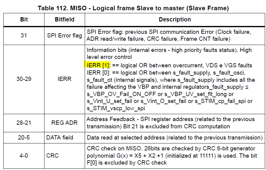

Hello. I'm using L9369 IC and have a problem.
Stage A is not working.
i made control code for Stage A,B. (they are very similar)
i used below two command for H-brdige operation.
0693W00000aIBOdQAO.pngbut. current was not flow.
here is phenomenon.
1.Low side GL1,2 is not working,

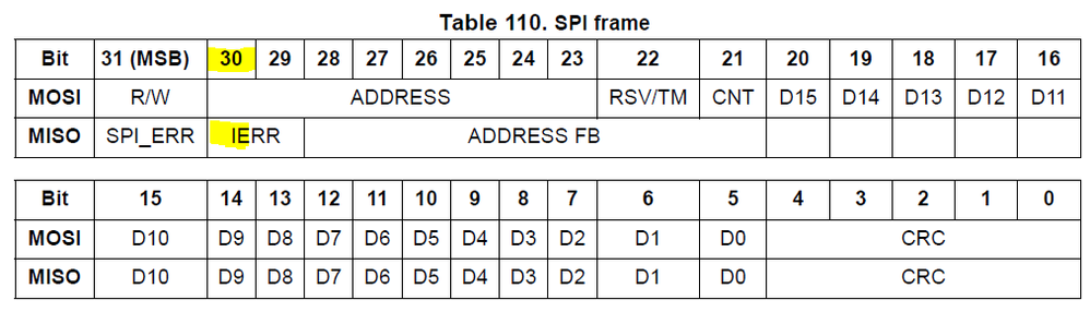

2. GH1,2 turn on/ off at same time.
3. IERR (bit 30) is set to '1'.
4.I read register 120d, there was no Over current detection flag.
refer to datasheet, bit 30 is IERR[1], and it designate OverCurrent VDS, VGS(what is 'e'? just typo?)
please let me know what register should i check?
thank you

             After debugging, it is found that IERR does not affect the drive of the H-bridge motor, but we do not find any error in the error status register related to overcurrent,VDS and VGS. Therefore, what is the reason for the failure of the IERR?
