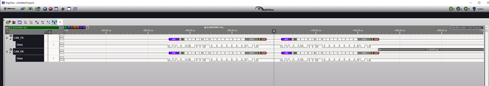

As I said before I can send messages but nucleo dose not read them or put them into FIFO. Data is comming in since pin PD0 is getting changes in signal (checked with HAL GPIO ReadPin). It's just that HAL library can't read and write this data into FIFO (ether 0 or 1) buffer.
I am using CAN BUS in Loopback mode and data passing is correct. This can be seen in screenshot from Data analyzer attached below.
0693W00000WKYSHQA5.pngLeads from Logic analyzer are attached DIRECTLY onto pins that are goin into nucleo's socket.
From output you can see what is the problem I am facing.

Also here is code for my CAN1 init and it's filter.
static void MX_CAN1_Init(void)
  /* USER CODE BEGIN CAN1_Init 0 */
  /* USER CODE END CAN1_Init 0 */
  /* USER CODE BEGIN CAN1_Init 1 */
  /* USER CODE END CAN1_Init 1 */
  hcan1.Instance = CAN1;
  hcan1.Init.Prescaler = 10;
  hcan1.Init.Mode = CAN_MODE_NORMAL;
  hcan1.Init.SyncJumpWidth = CAN_SJW_1TQ;
  hcan1.Init.TimeSeg1 = CAN_BS1_11TQ;
  hcan1.Init.TimeSeg2 = CAN_BS2_4TQ;
  hcan1.Init.TimeTriggeredMode = DISABLE;
  hcan1.Init.AutoBusOff = DISABLE;
  hcan1.Init.AutoWakeUp = DISABLE;
  hcan1.Init.AutoRetransmission = DISABLE;
  hcan1.Init.ReceiveFifoLocked = DISABLE;
  hcan1.Init.TransmitFifoPriority = DISABLE;
  if (HAL_CAN_Init(&hcan1) != HAL_OK)
    Error_Handler();
  /* USER CODE BEGIN CAN1_Init 2 */
  CAN_FilterTypeDef canfilterconfig;
  canfilterconfig.FilterActivation = CAN_FILTER_ENABLE;
  canfilterconfig.FilterBank = 27;
  canfilterconfig.FilterFIFOAssignment = CAN_RX_FIFO0;
  canfilterconfig.FilterIdHigh = 0;
  canfilterconfig.FilterIdLow = 0x466<<5;
  canfilterconfig.FilterMaskIdHigh = 0;
  canfilterconfig.FilterMaskIdLow = 0x466<<5;
  canfilterconfig.FilterMode = CAN_FILTERMODE_IDMASK;
  canfilterconfig.FilterScale = CAN_FILTERSCALE_32BIT;
  canfilterconfig.SlaveStartFilterBank = 0;
  HAL_CAN_ConfigFilter(&hcan1, &canfilterconfig);
  /* USER CODE END CAN1_Init 2 */
Before anyone points out "oh you have ID wrong" here is the header for TX message:
  TxHeader.DLC = 8;  // data length
  TxHeader.IDE = CAN_ID_STD;
  TxHeader.RTR = CAN_RTR_DATA;
  TxHeader.StdId = 0x466;  // ID <---- CHANGE FOR EVERY DEVICE!
Now I'm going to install older version of CubeIDE since this must be some sort of a bug in HAL library. I tried to set up ETH and LWIP before without luck... Now I can't set up CAN....

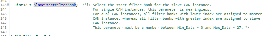

You have done a configuration for a bxCAN Slave Filter ;)
This line defines all filterbanks abov this value (here it is 0) will linked to the bxCAN Slave.
And you do a configuration of the
So your messages will go to the non configurated bxCAN Slave.
Change this both values to usefull numbers.
