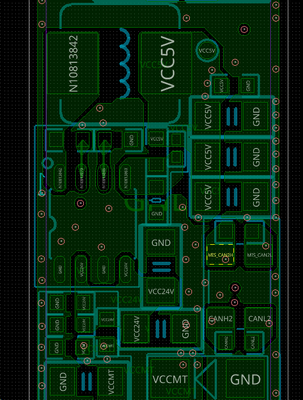

Here is the PCB of our product:

My only suggestion is to revise the layout. It is important to observe the basic design guidelines for switching regulators:
  • clean separation of the main current path and sensitive surroundings (feedback line, etc.) instead of a large, shared GND plane
  • route the main current path on one level without vias if possible
  • etc

You probably connected the stepper motor to VCCMT and thus decoupled it from the L6982 via FL2? What is the inductance of FL2?
Nevertheless, depending on the operating conditions, overvoltage pulses from the motor can have a retroactive effect on the L6982 and possibly cause the problem you observed. This could result in a latch-up effect or maybe the overvoltage protection being triggered.
Your layout looks good, at least in the visible area. Unfortunately, the presumably large GND plane, to which many GND vias are connected, is not shown. Have you considered separating the current paths cleanly, e.g. by using star-shaped GND routing?

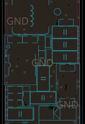

Our design uses a 6-layer PCB with complete ground plane layers, as shown in the figure below.

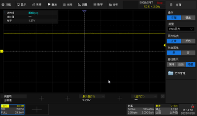

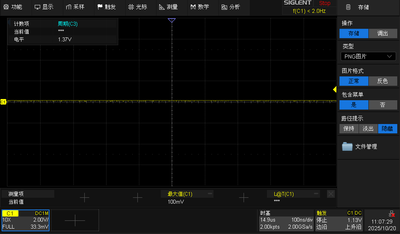

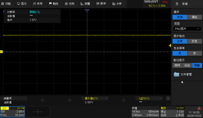

The failure occurs during the product aging test process, involving forward and reverse switching of the motor with intervals in between, but without external reverse rotation. Below are some failure test waveforms:
SW PIN
BOOT PIN
VCC PIN

After taking a closer look at your layout, I can't see significant problems. The pin FB is very close to the buck coil, but small enough not to pick up switching signals if the buck coil is not magnetically shielded.
However, I think I have found a bigger problem: choke FL2 is only an EMI suppression ferrite bead, whose inductance is probably not sufficient to keep steep pulses from the motor away from the buck converter. Please replace it with a coil with significant larger inductance, e.g. 1...2mH and enough current capability.
