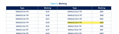

Please help finding what diode is this, picture attached, the marking looks like 6BD,
Thank you for any help provided.
SMA6J8.5CA-TR
600 W, 8.5 V TVS in SMA
https://www.st.com/en/protections-and-emi-filters/sma6j8-5ca.html
