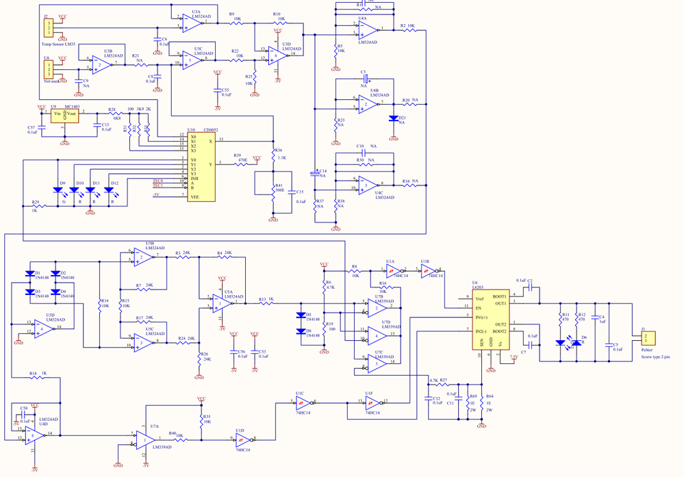

We are using L6203 IC in production with annual consumption of 400 Nos. The product where it is used in biomedical instrument used for blood analysis and diagnosis. IC L6203 is used for controlling temp of peltier from 3 set poins (25,30 and 37 �C) and temp can be changed to any values either 25,30,37 �C from its earlier set value ( either heating or cooling )
Temp is sensed using LM35 temp sensor and using analog circuitry it is assigned to EN, IN1 and IN2 pin of L6203 to achieve set temp.
Attached schematics and in design, D6(red) is indication of heating and D7 is indication of cooling.
As per our observation when it is heating , D6 (red) is glowing.
when is is cooling , D7(green) is glowing.
But after stabilizing temp to set value, 4 conditions are observed  ( only D6 is ON, only D7 is ON, Both LED ON, Both LED OFF ), but temp is controlled correctly as per provided settings.
So please guide us 'why LED indication is different when set temp is achieved'? Otherwise L6203 is operating correctly to heat or cool as per settings. Only problem is of indication.

When both leds are off the Peltier driver is disabled by the state of the 2 off schematic inputs. U7-5  U7-10

@dvorak.peter, Thanks for reply. When temp is already achieved we are seeing different conditions as below in different PCB's:
Can you suggest for this? Why it is glowing 'either of D6 or D7 or both ON/OFF' randomly?
Posted on March 05, 2018 at 17:13
On the enclosed schematic the equal  values for R8 and R16 are strange. It may put the logic input into undefined region.  R16 should be 2 kohms or lower.
For troubleshooting you need more complete schematic.
Peter

We tried with 2K value at R8 and R16 but still same issue. Attached schematics. J2 is connected to LM35 temp sensor.

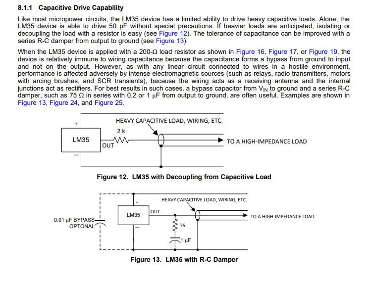

The LM35 connection violates design guidelines in
http://www.ti.com/lit/ds/symlink/lm35.pdf
section   8.1.1 Capacitive Drive Capability
The design should add 75 ohm resistor in series with C6.
R8 and R16
 should remain 10k )
Peter

After adding resistor in series with c6, still same problem is observed ie after attaining temp LED indication is different everytime.
