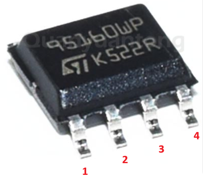

I am using the M95P08-IXMNT/E flash memory IC and I am unable to identify the Pin-1 orientation on the package.
The device does not appear to have any visible:
  • dot/dimple
  • chamfer
  • laser marking
  • beveled corner
I checked carefully under light and magnification, but I still cannot find any Pin-1 indication.

+ Generally you can follow the marking orientation:

The edge starting with pin 1 is a bit different, see picture.

The SO-8 package should have a chamfer on the Pin-1 side.
Can you share a clear picture?
