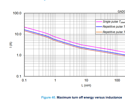

Even if I go to the data sheet of VNQ7E100AJTR, the numbers are not written like the answer above.
Peter BENSCH

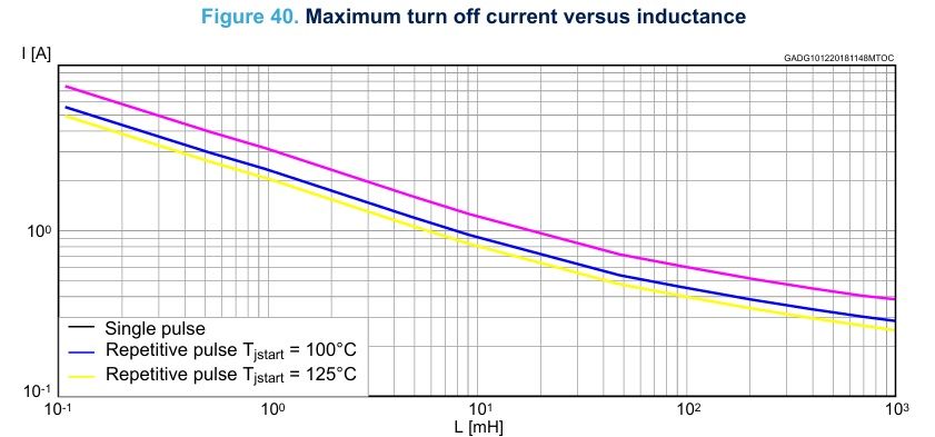

Your posted excerpt seems to be from an old data sheet, in the current revision the figure has the number 39. Irrespective of this, this picture shows the turn-off current via a connected inductor, which does not have much to do with your question.
There are no diagrams in the data sheet for the maximum current, as it depends on several parameters. To avoid overloading, the current is therefore limited internally - with less cooling, you inevitably have more heating and therefore tend to have an earlier limit.

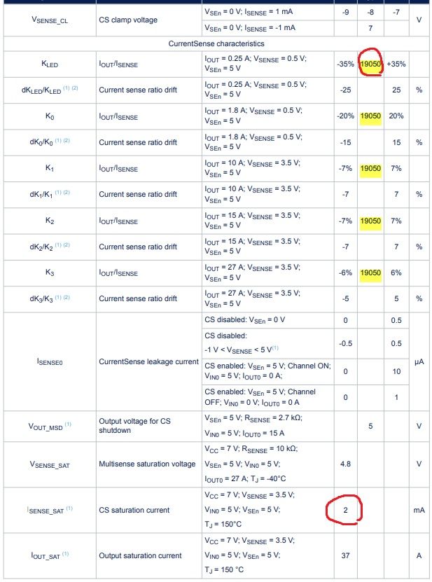

However, there are practical limits for the current: the CS pin supplies a maximum of 2mA, which corresponds to an output current of 38.1A with the typical factor of 19050. You can therefore no longer measure larger currents with the current sense.

I was able to find the 19050 and 2mA that PETET said in that part. Is that right?
By the way, the test was based on 5V, but can I get the same result even though it's based on 12V? I just multiplied the two and got 38.1.. I honestly don't know what it is. I'm sorry.
