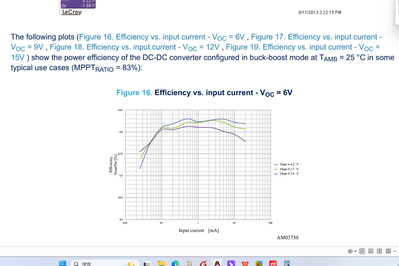

If SPV1050 is used, my questions are as follows.
1. How is the MPPT (Maximum Power Point Tracking) achieved? CVT (Constant Voltage), P&O (Perturbation and Obstruction) Observation method), IncCond(Incremental conductance method).
2. How to set MPPT through R1-R2-R3? For example, if the open-circuit voltage of my photovoltaic panel is 6V, and the tentative MPPT voltage is 6 * 0.8 = 4.8V, then what are the resistance values of these three resistors?
3. The battery charging cut-off voltage is 4.2V, and the under-voltage is 3.6V. How to set the values of R4-R5-R6?

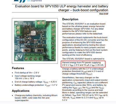

4. How were the R1-R2-R3 in the schematic diagram of the development board STEVAL-ISV020V1 calculated? What is the MPPT setting voltage for it?
5. How were the following parameters of the development board STEVAL-ISV020V1 set?
6.when the inupt current >20mA,what is the efficency?
