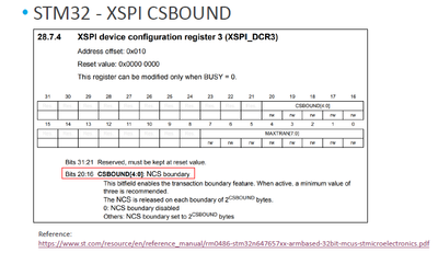

Please use APS256XXN-OB9-BG, this is latest device revision (highest speed grade covering all previous) for this PSRAM family and fully compatible with STM32H7S7 without any change, (as well as all other STM32 supporting OPI). See attached some more comment and recommendation.

I'm happy to report that we used APS256XXN-OB9-BG with succes in our custom pcb

Good to and thanks for the confirmation using the "OB9" version successfully
you can use the "OBR" & "OB9" version with the same configuration.
The report is advising a second point, which is the recommendation to use the CSBOUND function, rather the  RBX read option (row boundary crossing). if your SW is already done, no need to change, but if not, this is a better habit to take.
Cross-page access: Method 1: By PSRAM RBX(Row Boundary Crossing) feature if available
Single-page access: Method 2: By controller page-boundary setting if available   => RECOMMENDED
