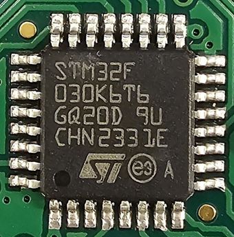

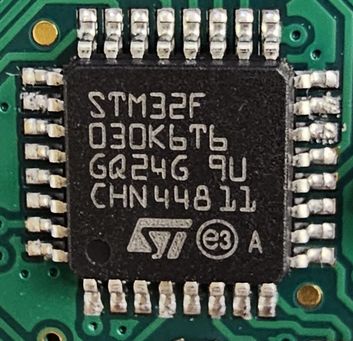

Is there a difference in firmware or other features between two batches (GQ20D 9U CHN2331E) and (GQ24G 9U CHN44811)?
The 1st batch number is not booting everytime compared to the 2nd batch number, when pulling Pin26 high. not good.jpg  good.jpg
The fault carries if I swap chips.

The reason I was speculating that it's the chip is all other date codes we have programmed work fine, but the chips coded GQ20D 9U CHN2331E don't function as intended.
The Technician had a known working assembly, removed the chip and put the suspect chip on. The fault of not booting every time has now carried over to the known working assembly.
