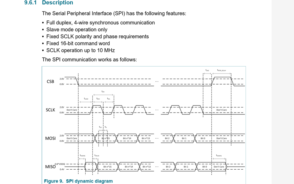

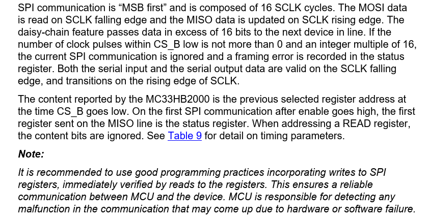

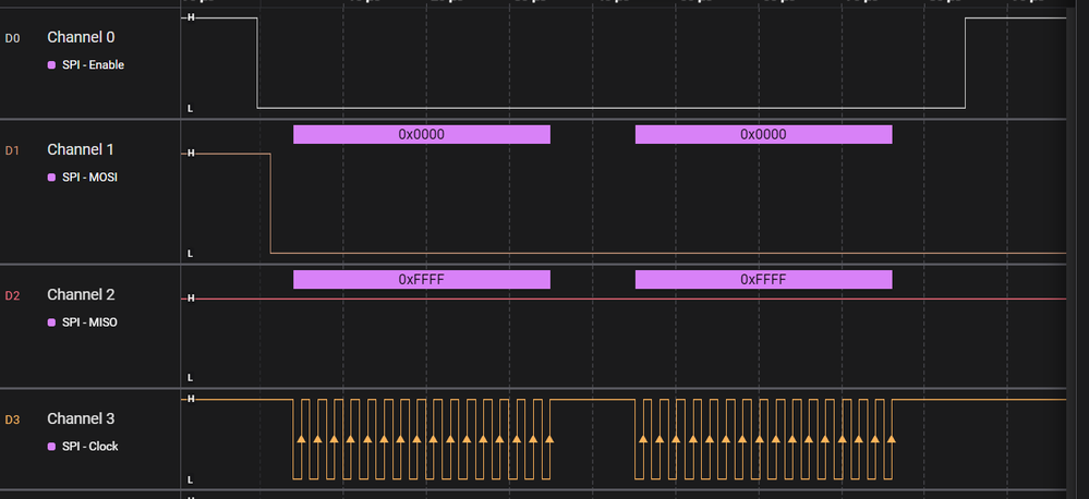

here i'm for another question, are a day i'm go crazy with the SPI interface . I try to comunicate with MC33HB2000EX 10 A H-bridge, SPI programmable brushed DC motor driver. The datasheet write that:

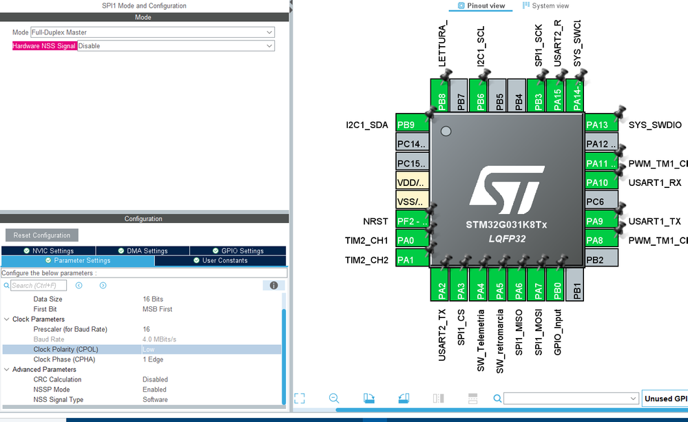

So i configure my SPI :

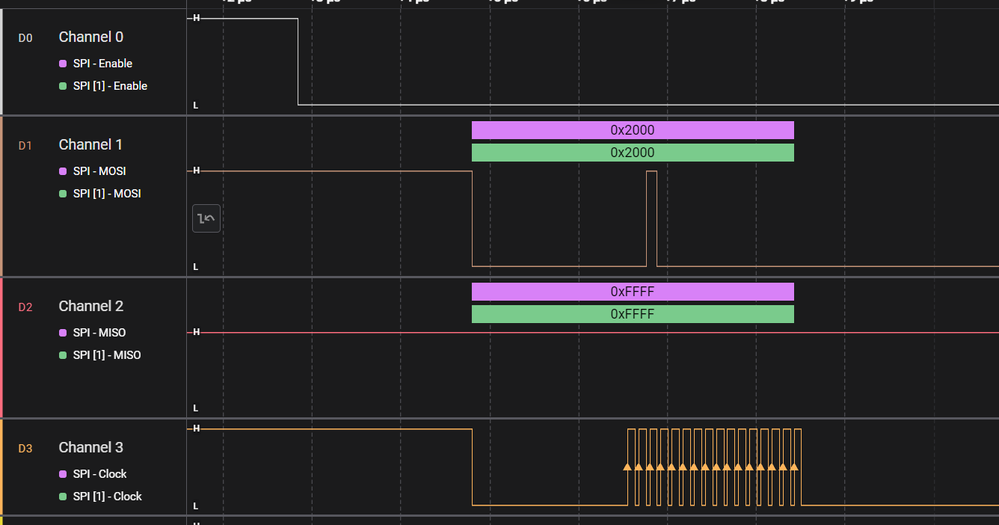

no one data come out from MISO and i put on my analaizer and i don't understand why the clock start to logic high and no from logic low i don't know if is the real problem
I hope someone can help me
Thank you
Sergio
How do you know it doesn't work?
Show the signals.
I think CPOL = 0 (low) and CPHA = 1 (2nd edge). The other possibility is CPOL = 0 and CPHA = 0.

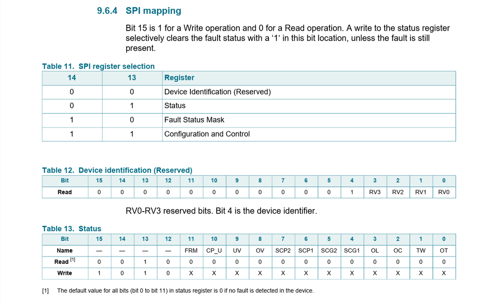

Maybe 0x2000 is not the right command.

First you need to understand how SPI works. To receive, you need to send something. I only see 16 clocks.

i try but still dosen't work

and i configurate my SPI in this way :
CPOL = low
CPHA 0 2 Edge
Baud rate 500Khz

As you did before, you should send 0x2000 and you are sending 0x0000.

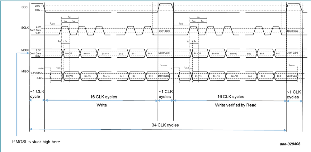

Sorry, in the last post i try to send 0x0000 is another register , is correct what i did but still don't work. I find one doument on internet and this say
what confuse me is CPOL and CPHA
