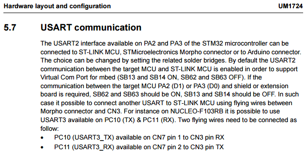

I have already asked this question on the mbed site:
https://developer.mbed.org/questions/59656/Serial-What-are-the-Supported-pins/
It isn't clear from the Handbook whether this is even supposed to be supported. I tried instantiating as:Serial uart4( PC_10, PC_11 );
But is seems that can't be sufficient, as USART3 can also use PC10 & PC11 - so how could it know?!

Well the ST-LINK VCP is definitely USART2 via PA2/PA3 on the
https://developer.mbed.org/platforms/ST-Nucleo-L152RE/
But somewhat irritatingly that conflicts with the D0/D1 of the header.I'd have to wade through the manuals for USART3/UART4, but I could swear you'd have to manually modify the board to get those to the VCP TX/RX pins.Up vote any posts that you find helpful, it shows what's working..

UART4 would also be viable on these pins, if you really needed to use USART3 somewhere else and in synchronous mode. With 64-pins I find that a tad improbable.Not into mbed myself, but would suspect calling out the U(S)ART and specifying the pins to select as AF, should be enough for the magic inside the board/chip support code to get the chip set up properly, provided you'd dealt with the wiring externally.Up vote any posts that you find helpful, it shows what's working..

Sorry - I'm not talking about the
ST-LINK VCP here at all.
I have serial comms with the PC over theST-LINK VCP working fine.
What I'm looking to do is to also have UART (or USART) comms on the header pins.The UART4 pins seemed initially convenient - but any other pins would do.I'm also not much into mbed (yet) - but the documentation on this does seem very skimpy (being kind).:(A complex system designed from scratch never works and cannot be patched up to make it work.
