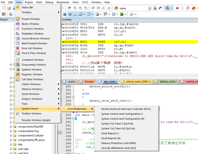

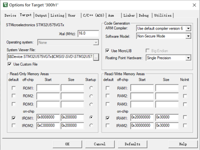

I couldn't look at the registers while using Keil. The chip model is STM32U575VGT6. I remember the wrong package to install stm32U5, he said there was a file error, but I could still compile the U5 series chips. Is it because of this? now how do I install the package correctly. Attached are some picture descriptions

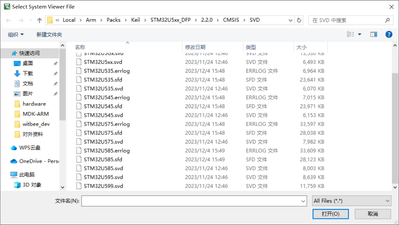

Hello @Alpha_Lee ,
I recommend you to take a look at this FAQ How to add or update the SVD file in different toolchains: An example using NUCLEO-U575ZI-Q board and to follow the steps shared in section 3.3 Add SVD file in KeilĀ® to add or to update the SVD file in a project
Please let me know if the issue is solved or not?

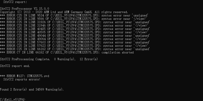

The command "SVDConv STM32U575.svd --generate=sfr" produced an error.

ā2024-02-28 12:09 AM
After I upgraded the keil version, it worked. Thank you for your reply.
