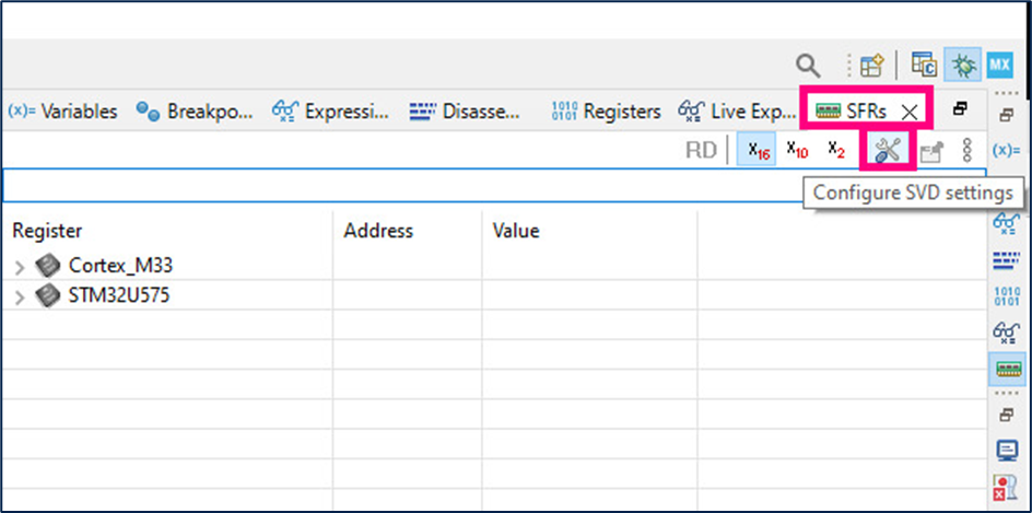

4.Click Window -> Show View -> SFRs.

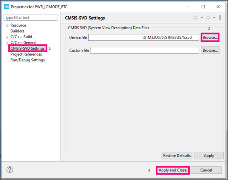

5.Click Configure SVD settings as shown in the below figure.
6.Browse the .SVD file as shown in the below figure.

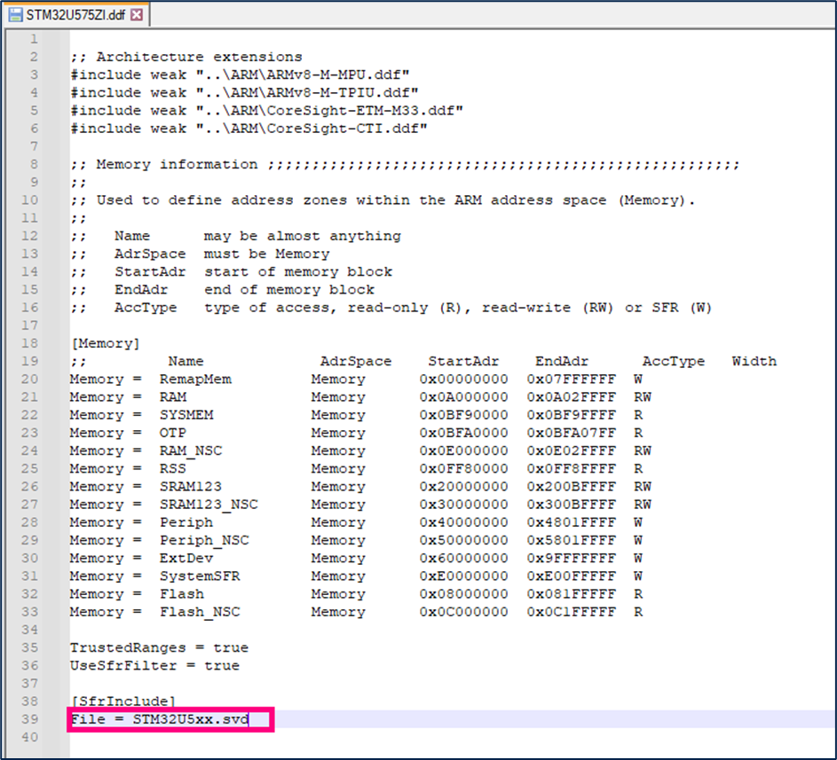

3.Copy the STM32U575.svd file that you downloaded from STMicroelectronics web site in \IAR Systems\Embedded Workbench 9.0\arm\config\debugger\ST folder.
4.Open the STM32U575ZI.ddf file in IAR Systems\Embedded Workbench 9.0\arm\config\debugger\ST folder, which corresponds to the MCU mounted on the NUCLEO-U575ZI-Q board.
As you can see in the above figure, the STM32U575.ddf file uses the STM32U5xx.svd file.
5.For that, modify the STM32U575.svd file name that you add in \IAR Systems\Embedded Workbench 9.0\arm\config\debugger\ST folder to STM32U5xx.svd.

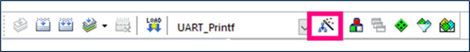

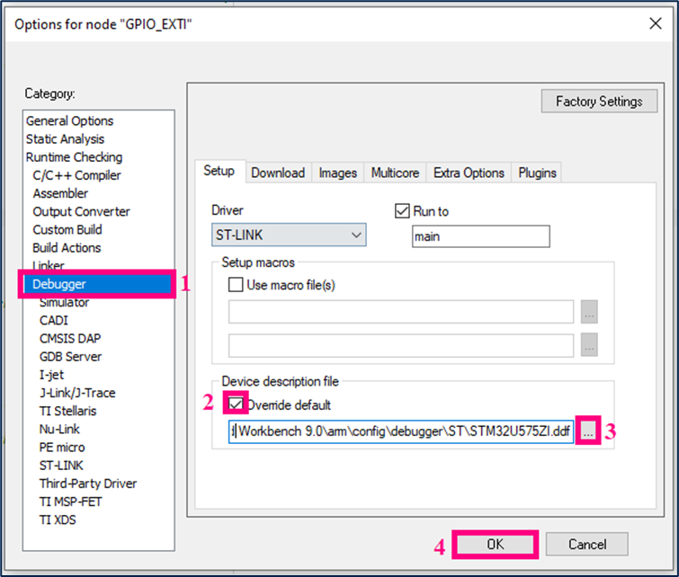

6.Open IAR tool chain.
7.Click Project -> Options.
8.Browse the SVD file as shown in the below figure.

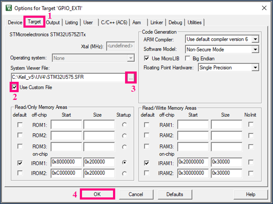

3.3 Add SVD file in Keil®
1. Download the system view description from this link: STM32U575 and STM32U585 microcontrollers - STMicroelectronics.
2.Extract the file that you downloaded from STMicroelectronics web site.
3.Copy the STM32U575.svd file that you downloaded from STMicroelectronics web site in…\Keil_v5\UV4 folder.

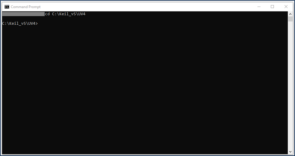

4.Open Command Prompt and write this command "cd …\Keil_v5\UV4" to change directory for UV4 folder and press enter.
5.Write this command "SVDConv STM32U575.svd --generate=sfr" in Command Prompt and press enter to convert the STM32U575.svd file to STM32U575.sfr.
6.Check if the STM32U575.sfr file is created in UV4 folder.
7.Open your project with MDK-ARM toolchain and click “Options for Target” as shown in the below figure.
8.Browse the STM32U575.sfr file generated in UV4 folder as shown in the below figure.

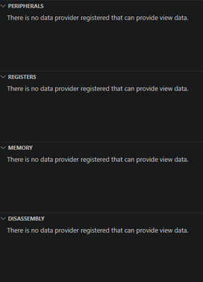

How does one add the SVD file into the VSCode extension for STM32?  Right now, I'm looking at:
October 8, 2026
in the launch.json file, add the path of the svd file
