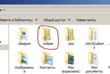

Hello everyone. I facing next problem:
Just yesterday, TrueStudio worked perfectly, but program lost its lost capability to compile anything (not older project, that I compiled nicely till yesterdey, not new, CubeMX-generated projects).
I'm getting build output just like on attached screenshot with every project.
Also, I've got one of compile outputs, that consisted of messages like this: junk at end of line, first unrecognized character is '*'
Only thing I could tie to what's happend, is that I've installed ASAP Excel utility, BUT I've DELETED it already, REINSTALLED TrueStudio, and getting same result.
Also, CubeMX has updated it's libs today, but since older projects don't work as well, I don't suppose that it's him...
No one beside's me didn't touched computer, so I'm pretty sure, that no preferences was changed manually.
Any help/hints, what could it be? Thank you.

‎2018-12-04 4:38 AM
SO, OK, I've found a solution
Somehow, TrueStudio's workspace have been glitched.
I've deleted .eclipse folder in my Users directory,
and Studio compile everything just right, now.
As for CubeMX project, that all is started with - it still generates same issue, yet it don't crush down compiler for every project any more.

I would guess your ... Excel tool messed up some registry entries or system variables Truestudio is relying upon.
That points to the registry, Windows' (TM) most famous Single-Point-Of-Failure (TM).
I would try a registry cleaner, there are several good freeware apps around.

Check also Environment Variables
Try creating another User instance on the machine and install and test in that.
Watch also for AV software playing interference. ​
