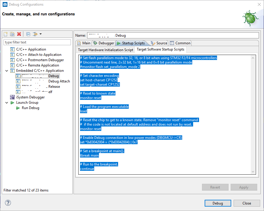

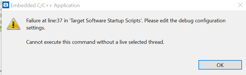

I'm using Atollic 9.1 with a Cube-generated project on F413 Nucleus board. When I debug (clicking on green bug icon), I get a message that debug failed, with debug context stopped wherever it stopped in the previous debug session. If I click on the green 'continue' arrow, debugging then stops at the breakpoint in 'main' as expected. What's going on? Did not see this problem with the previous project using F407 (F4 Discovery board). Here's the error it pops:

In Atollic, go to Run->Debug Configurations
Under Embedded C/C++ Applications choose your debug configuration, then go to
Startup Scripts->Target Software Startup Scripts
There you will find script that looks like this.
Find line 37, and
  • correct line (if you know what is wrong), or
  • comment out line (with #, if you do not know what is wrong)
@stikla​ - Unfortunately it is failing on the "continue" (with error: cannot execute this command without a live selected thread). This seems to be a well-known problem at least for Segger users, and there seem to be some GDB patches related to the problem. Erich recommended adding a wait, but that didn't work. Any other ideas? Thanks!
