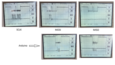

From the scope, top row is from the STM32WB55, bottom row from the Arduino.
Channel 1 - top trace is the CS line. I couldn't get a reading of the clock & the CS line one the Arduino, as soon as I probed SCLK then the chip errored out and just returned 0s & the clock & CS traces interfered with each other..
The STM MISO line is always 0 no matter what command I send, so no ID, no axis data, always 0.
I notice the CS line has that blip which I assume is the gap between bytes being sent?
SCLK is bang on 4MHz
Looks like it.

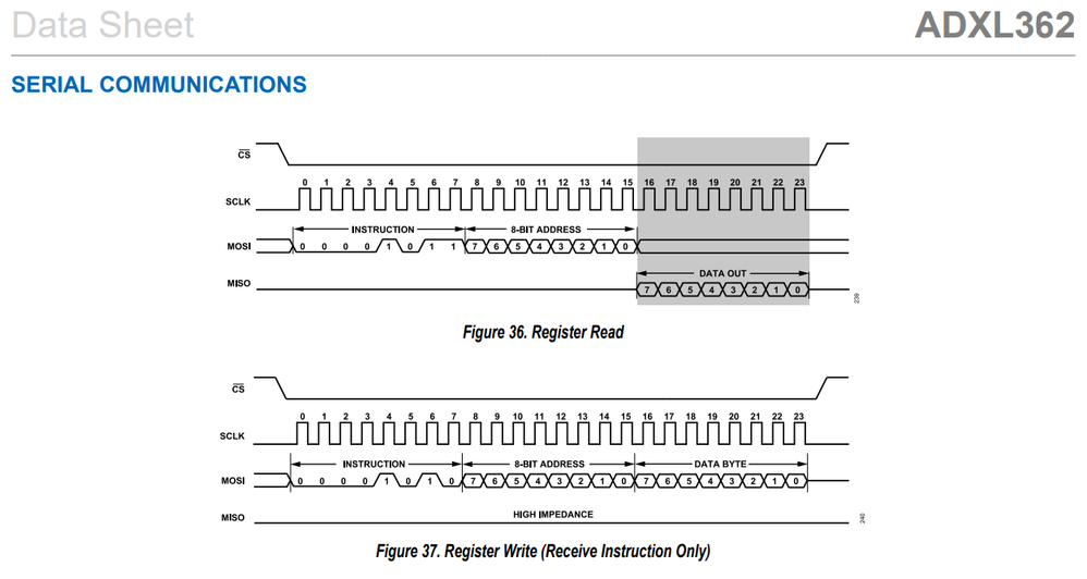

That'll be (at least one reason) why it's not working - CS should stay low for the entire transaction:
 Yeah that's what I was expecting.  I cant see it in the code unless the CS is being taken care of in the HAL & I shouldn't be setting & resetting it in my ADXL362 driver?
On STM32's most SPI requires you drive the CS from a GPIO. It's automatic operation is not good, and needs SPI enabled/disable across the transaction.

Anyway, it looks like I have no control over the CS line (PA4). When I clock through the code in the debugger & get to the line,
HAL_GPIO_WritePin(ADXL_GPIO_Port, ADXLCS_Pin, GPIO_PIN_RESET);
 The trace on that pin stays HI only when,
HAL_SPI_Transmit_DMA(adxlParams.hspi, command_address, 2);
is called does the CS line get pulled LO & then it exhibits the behaviour above, i.e. the CS line goes HI between each byte sent. I cant find anywhere in the HAL_SPI_Transmit_DMA() function that is acting on PA4, so that's puzzling.
