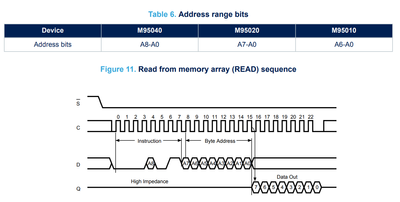

We are using M95040-DFMN6TP SPI PROM on our board.
The Serial Input/ Output timing given in the datasheet is not detailed.
There is not much info on the address width and data width, and how to control write/read, there also isn't the register definition.
Could you please point me to the document which provides these details, similar to the one in the image attached.

Isn't it in the datasheet, in table 17 and figures 19-21?
https://www.st.com/resource/en/datasheet/m95040-df.pdf
Address width is in there too.

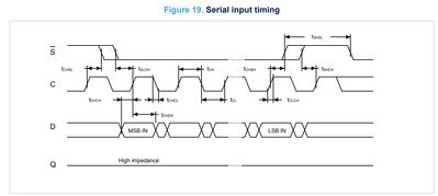

Could you please share the timing parameters of the M95040-DFMN6TP equivalent to the below.
During Write operation:
tds= Data set up time w.r.t Clock
tdh =Data hold time wrt Clock
During Read operation:
tcs = Chip select to Clock set up time
tch= Chip select to Clock Hold time

Could you please provide your response to my previous posted query:
