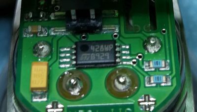

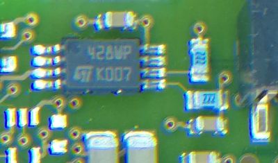

Can anyone help me identify the component(s)?  What kind of components these and what is the type of package (SSOP8 or TSSOP8)?
Please see the the pictures.
Thank you.

the marking 428WP stands for the  M24128-BWDW6TP in TSSOP8 (169mil), which is already on NRND (Not Recommended for New Design) because of the limited operating voltage range 2.5-5.5V.
The recommended replacement offer identical behaviour and a wider operating voltage range of
Does it answer your question?

Thank you for your help and quick response. I will analyze the circuit according to the information received. I hope I can fix it.
