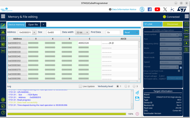

I am working with the STM32F103RCT6. I am writing a bare metal code for delay function using SYSTICK timer. The problem I am facing is that I am not able to write to the ARM cortex registers. Below is my code for your reference -

Below is the screenshot of the cube programmer window after I flashed the code -
As you can see, the SYSTICK registers do not have the value I tried to write. My code only contains this piece of code which I shared. Is my code missing something that needs to be added or some other register that needs to be configured?

mfgkw
Senior III
Is the program only flashed or is it started and running?
I flashed the code but it didn't work. Then I debugged the code and saw that the system ticks are not incrementing. I flashed the code and then checked the register contents on cube programmer. The SYSTICK register was not set as you can see in the screenshot.
I'm not sure of the efficacy of using STM32 Cube Programmer in this manner.
Can't you use the debugger, and do a "peripheral view", or for that matter using a serial port to dump the register content of interest to the terminal?
You shouldn't need to start HSI, the MCU will implicitly by running from the HSI when it first starts.
Check BOOTx pins as to what code starts.
Check SCB->VTOR points to your vector table, and that it's correct.
Double check what the NVIC is doing.
I haven't written any code pertaining to NVIC. This is the only code I have written in the empty project and flashing on the MCU. The boot0 pin is connected to GND. Also, I enabled HSI just for readability and specifically showing in the code that HSI is being used. So, should I remove the HSI code ?
Are you calling those functions? Attach your main.c file.
Maybe only do a single write to CTRL.
I'm just saying to inspect the relevant plumbing to understand why the interrupt is not occurring.
You need to follow the code flow, not sure if the code is running at the point you're inspecting the Cortex registers, would perhaps read a couple of the registers rather than a block of 0x400 bytes.
Generally better to do in the debugger, and whilst stepping through the code.
Perhaps check also with working HAL code, to see what the register look like in working cases.
