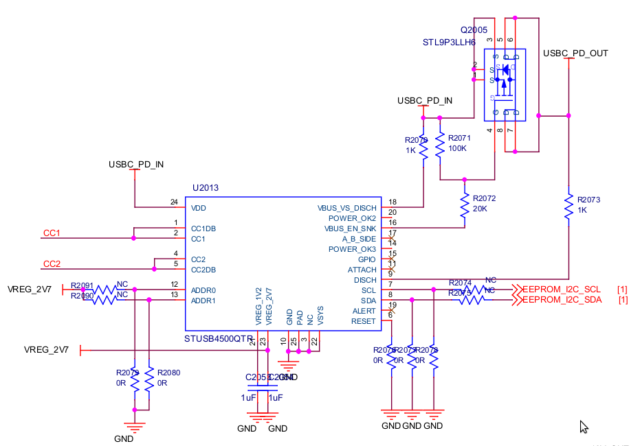

This is the PD schematics, and I try to set the PDO1 5V 1.5A, PDO2 9V 1.5A, PDO3 12V 1.5A, and send soft reset
Are these the correct configuration steps?

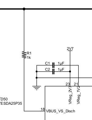

Looking at your schematics, I see that you did not implement the discharge circuit as in our schematics (see below).
This circuit is recommended, especially if you are expecting high current surge, because:
  • While stsub4500 is in explicit contract, if there is a current surge system, the drop induced by surge will be absorbed by the RC circuit in order to avoid stusb4500 to disconnect due to UVLO (VBUS monitoring is done through VBUS_VS_Disch pin).
  • During VBUS voltage ramp up, it has is no impact
Please add this circuit and let me know.
use the STREF-SCS001V1 schematic above,  Is this difference the cause of the problem?

If you have some spurious on VBUS, it could be detected as "VBUS under-voltage" by the STUSB4500 : these schematics filter these unexpected drops.
For changing the PDOs, you have to change the PDO values through I2C, and then you must apply a SW reset or a HW (through reset pin) so that the new values are considered (note that a HW reset will also generate a disconnection of the Source, which will renegotiate a new power profile with the Sink at next connection).
