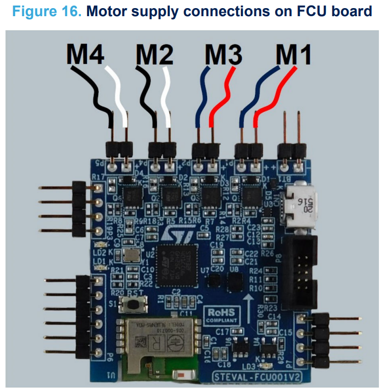

We have 2 nos of STEVAL Drone 02. 1)We assembled correctly the motors CW & CCW 2) Propellers are also correctly assembled. We are using STBLE Drone androidapp. We are facing same problem for both the units.
Propellers rotates in proper direction  but its not lifting up.instead it lifts slightly 25 cm above ground & then starts rotating around itself & moves horizontally uncontrolled. Then we have to stop it.

Tip: Don’t take anything for granted or assume it’s correct. There are ST errata sheets in the Steval Drone Kit 1 documentation that mention that for V1  years ago, some lots had motors with the white and black wires reversed in the kit, so even if you follow the manual, it could still be wrong...

1- Are you sure about the motor connections and polarity:
