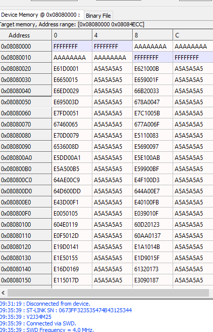

I'm trying to use the emulated EEPROM on the b-l475e-iot board... I'm following the example from X-Cube-EEPROM, and everything looks ok... when it goes through storing values and then reading them back, everything matches... but if I try to read the data at startup, I get an EE_NO_DATA error.

Perhaps don't EE_Format(EE_FORCED_ERASE); every time through?
You're right, that shouldn't be there, but I'm seeing the same result. I had been trying to save values as floats instead of uint32 but it was failing, and I thought formatting might help and I forgot to take it out.
You could perhaps inspect the memory with the STM32 Cube Programmer to confirm there is content in the sectors used by the EEPROM emulation.
DSabo
So I can see the values change in memory... I changed it so each variable is written as 0xA5A5A5A5.
I verified that it is staying in memory after a reset by changing the code so at startup it doesn't do anything until the user button is pressed, and then connected the St link utility and the values are there OK.
Edit: As I've been continuing to look into it, it looks like sometimes the eeprom memory is erased and doesn't write... not sure what's going on
DSabo
Not sure why it wasn't working before, but everything looks like it is saving ok now.
