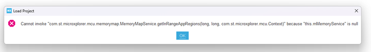

I attached the demonstration IOC file. I created new project for STM32N6570-DK board, enabled RAMCFG peripheral for Appli, checked the AXISRAM3-6 areas, defined single continuous area for those SRAMs in MMT and saved the project. After this CubeMX fails to load this IOC file. I get popup:
In textual form the error is: Cannot invoke "com.st.microxplorer.mcu.memorymap.MemoryMapService.getInRangeAppRegions(long, long, com.st.microexplorer.mcu.Context)" because "this.mMemoryService" is null.
The workaround is to not enable RAMCFG in CubeMX, rather control the peripheral manually.
