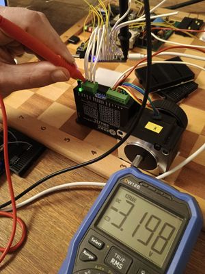

‎2024-02-15 9:43 AM - edited ‎2024-02-15 9:45 AM
I just checked it - attached you can see the situation ...
~now - "-3.3 V" (?!) - - thank you - but is there a possiblity to get a small "kick" to a little bit higher voltage ...
‎2024-02-15 9:52 AM
Numerous posts have all asked you to measure this with nothing connected.
I asked you, "Please confirm that is with nothing external connected to the Black Pill?" - and you show this:
So you do have external stuff connected!! :face_with_rolling_eyes: :face_with_rolling_eyes: :face_with_rolling_eyes:

‎2024-02-15 10:15 AM
That's my situation - 1,64 V - on load - measured to card -
But I need at least round about 3.6 V ... USB Voltage tap per software possible?
