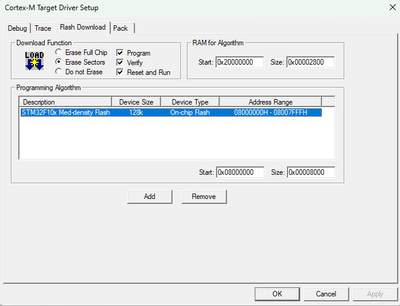

Hi, I'm getting started at embedded programming, I've got this blue pill board having the STM32F103C6 MCU and ST-LINK v2 programmer.
Here's my code, just to light up the LED on port C 13:
Despite the IDE flashes successfully the LED doesn't light up as I wanted, It will only lights up if I add a break point on debugging mode on Keil uVision
And here are my flash configurations:
Any help is appreciated.

2025-09-11 6:16 AM
> which is weird because it turns on while setting the register and turns off when setting the set-bit = 1.
What I expected. Some LEDs are "active low". TL;DR this is not unusual, just depends on how the LED is connected.

2025-09-05 1:07 AM
PC13 needs to be LOW to illuminate the LED
GPIOC->BSRR = (1<<(13+16)); // RESET PC13, as LED ON with LOW state
while(1) {} // Infinite loop, so as not to exit
return 0;
