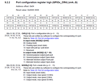

Hi, I'm getting started at embedded programming, I've got this blue pill board having the STM32F103C6 MCU and ST-LINK v2 programmer.
Here's my code, just to light up the LED on port C 13:
#include "stm32f10x.h"
int main() {
RCC->APB2ENR |= (1<<4);
GPIOC->CRH |= ((1<<20) | (1<<21));
GPIOC->CRH &= ~((1<<22) | (1<<21));
GPIOC->BSRR = (1<<13);
return 0;
Despite the IDE flashes successfully the LED doesn't light up as I wanted, It will only lights up if I add a break point on debugging mode on Keil uVision
And here are my flash configurations:
Any help is appreciated.

what is the CRH register? seems not consistent with the Reference manual.
and are you sure you are setting the GPIO output mode?
and also need to replace the return 0 with while(1).
Shirley.Ye
seems the GPIOC->CRH &= ~((1<<22) | (1<<21)); should be
GPIOC->CRH &= ~((1<<22) | (1<<23));
I did make such a mistake. After fixing bit register 21 -> 23, the LED turns on at
and turns off at
which is weird because it turns on while setting the register and turns off when setting the set-bit = 1.
What I expected. Some LEDs are "active low". TL;DR this is not unusual, just depends on how the LED is connected.
Thank you a lot, I didn't think of that case but thinking my board was broken.
