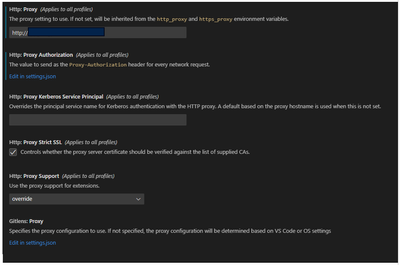

- Set VSCode Proxy http://user:pass@domain:port

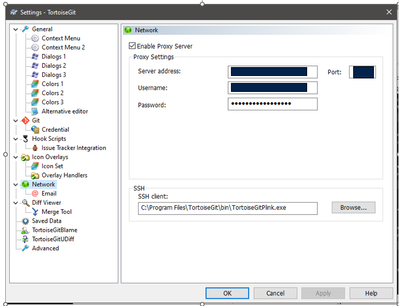

- Set Git Proxy correctly

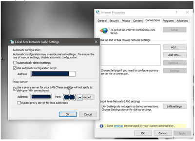

- Set IE proxy correctly

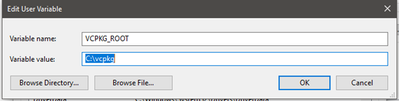

- Set VCPKG_ROOT env variable

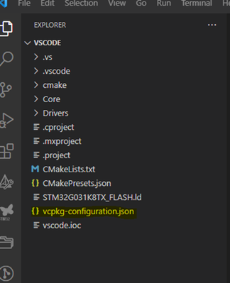

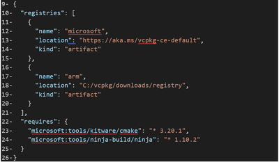

- Open vcpkg-configuration.json file
- Replace the content by this text and save
- Open C:\vcpkg\vcpkg-configuration.json and do this modification
