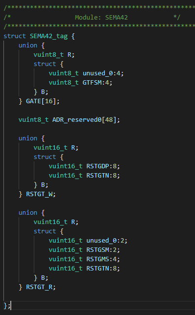

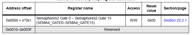

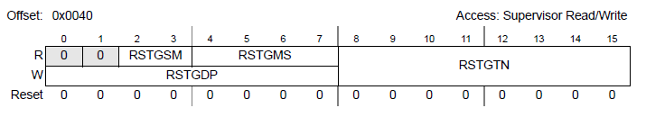

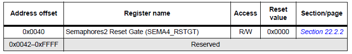

Hello, there may be mistake in ST library. In reference manual registers are like that.0693W00000LyDMdQAN.png0693W00000LyDN2QAN.pngIn the library SEMA4_RSTGT has two different addresses for read and write but those are in the same address.
0693W00000LyDOeQAN.png0693W00000LyDNgQAN.pngWith this when I try to reset gate it goes to one of error handlers, if I comment out RSTGT_W I can reset gates without any problem.
ODOUV.1
you are right this is an error in definition.
You can use this new definition instead of:

struct SEMA42_tag {
  union {
    vuint8_t R;
    struct {
      vuint8_t unused_0:4;
      vuint8_t GTFSM:4;
    } B;
  } GATE[16];
  vuint8_t ADR_reserved0[48];
  union {
    vuint16_t R;
    struct {
      vuint16_t RSTGDP:8;
      vuint16_t RSTGTN:8;
    } B;
    struct {
      vuint16_t unused_0:2;
      vuint16_t RSTGSM:2;
      vuint16_t RSTGMS:4;
      vuint16_t RSTGTN:8;
    } B_read;
  } RSTGT_W;
#define RSTGT_R RSTGT_W
