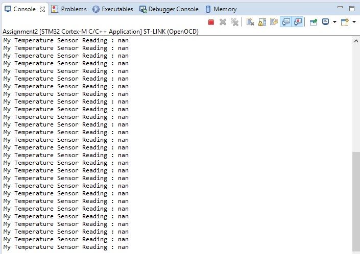

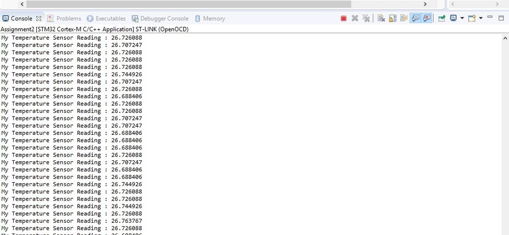

The first unit of B-L475E-IOT01A board is returning the temperature reading well to the STM32CubeIDE console panel. However, on the other board with the same code, the temperature sensor reading on the console is "nan". (both console reading captures below)
Is my other B-L475E-IOT01A board temperature sensor HTS221 faulty?
I have checked both B-L475E-IOT01A boards jumpers are identical.
Please advice what could be wrong for the board sensor and alternate methods to verify its temp sensor functionality for Board No.1 ? :sad_but_relieved_face:
Board No.1 - console panel capture
Board No.2 - console panel capture

Probably means "not a number", a value that printf can't display.
Check variable with debugger.
FIoT.1
Hi, the same code work well and return number on the other board.

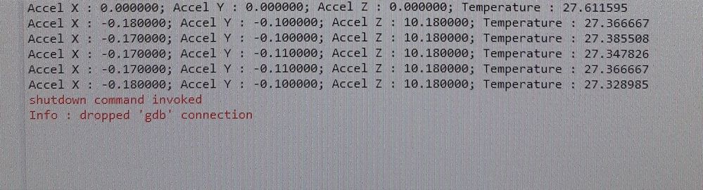

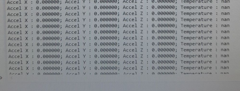

Just tested both boards on the additional accelerometer sensor component. On Board no. 1, it is returning only 0 for x , y , z acceleration values (after orientation changes) to the STM32CubeIDE console panel. However, on my other Board no. 2 with the same code, the accelerometer sensor reading on the console is reading well for the acceleration values. (both console reading captures below). Please advice. :hushed_face:

since both accelerometer and HTS221 sensors are failing, I don't think this is an issue related to the sensors... from the schematic, I see they share the INTERNAL-I2C2_SDA and the INTERNAL-I2C2_SCL I2C lines... can you please check if the MP34DT01-M microphones are working well?
