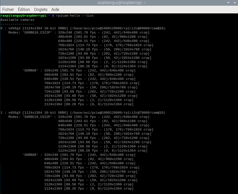

Both seem to be recognized:

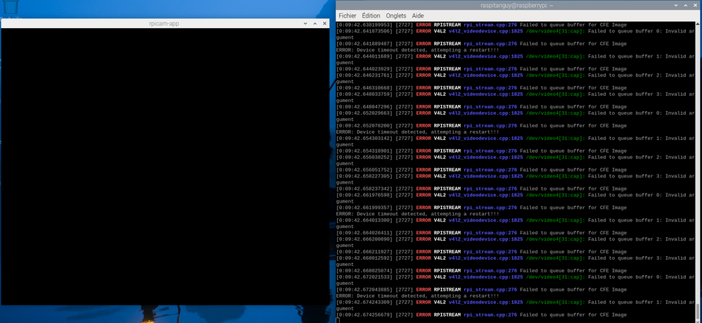

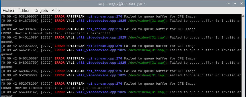

However, when I try to capture video from both cameras simultaneously, only the CSI0 port works. The CSI1 port returns the following error with this command ( rpicam-hello --camera 1):
I also tried a GStreamer command, but it didn't make any difference.

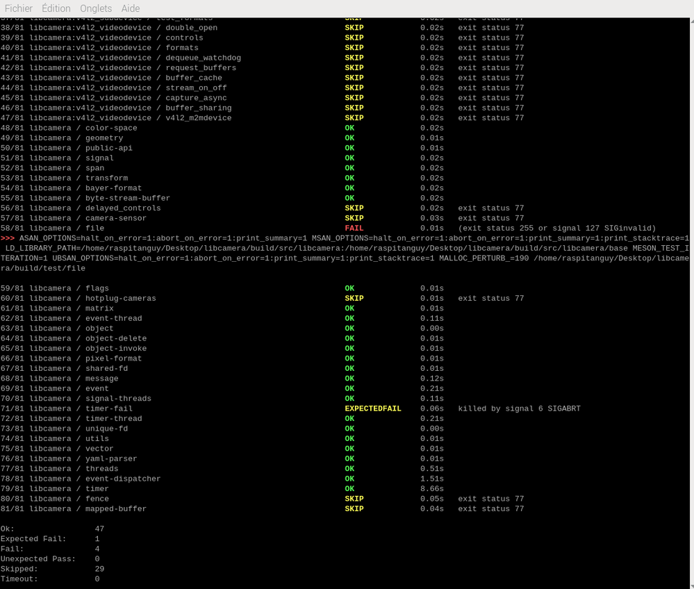

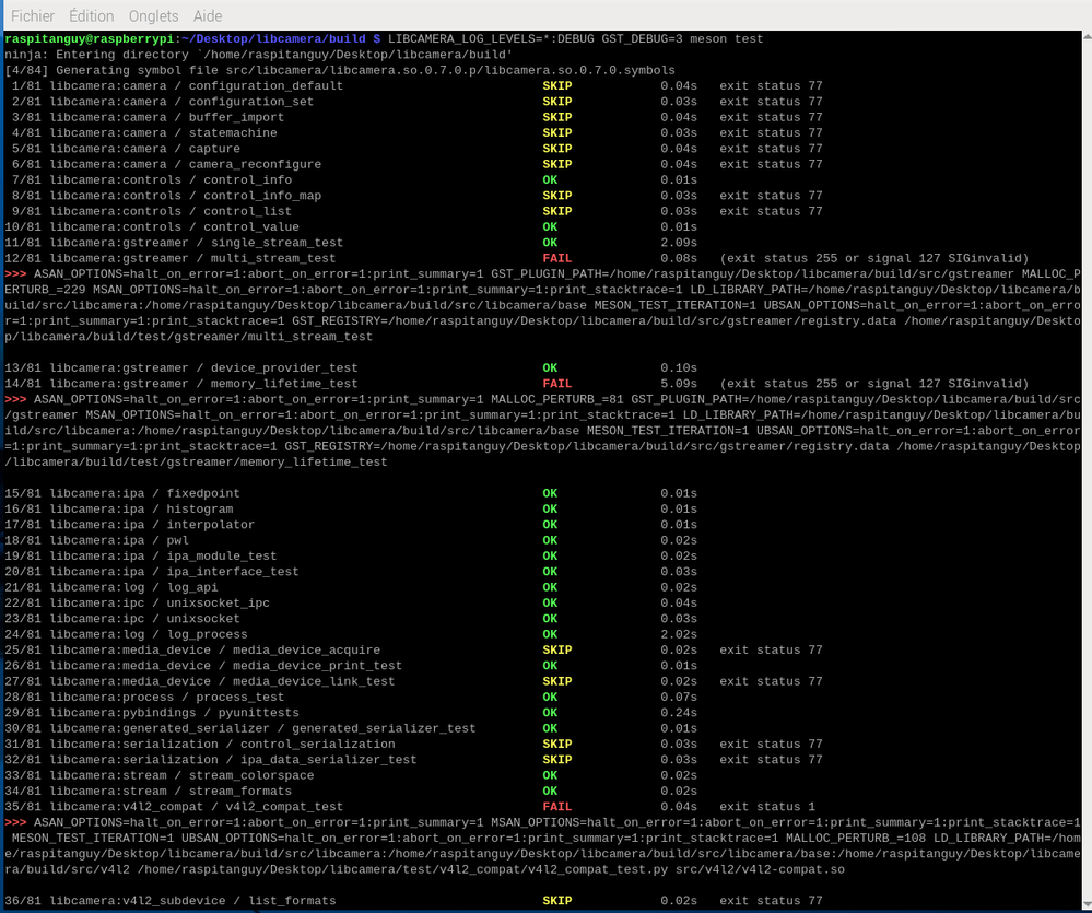

I carried out tests with only one camera connected on CSI1 of the dev board and I get the following results:
Note that I repeated the tests, but this time on CSI0, and the error related to memory_lifetime_test no longer appears.
Here is an excerpt from the kernel error messages when I try to display the stream on the devboard's physical CSI1 port:

[ 2195.158434] videobuf2_common: driver bug: stop_streaming operation is leaving buffer 0 in active state
[ 2195.159635] rp1-cfe 1f00128000.csi: Using a link rate of 804 Mbps
[ 2195.159776] rp1-cfe 1f00128000.csi: stream on failed in subdev
[ 2195.161721] rp1-cfe 1f00128000.csi: Using a link rate of 804 Mbps
[ 2195.161869] rp1-cfe 1f00128000.csi: stream on failed in subdev
[ 2195.164106] rp1-cfe 1f00128000.csi: Using a link rate of 804 Mbps
[ 2195.164290] rp1-cfe 1f00128000.csi: stream on failed in subdev
[ 2195.165736] rp1-cfe 1f00128000.csi: Using a link rate of 804 Mbps
[ 2195.166017] rp1-cfe 1f00128000.csi: stream on failed in subdev
