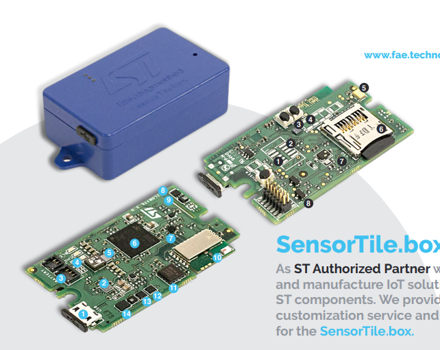

Manual says "The board includes the ST-LINK V3 (with UART pins for debugging) compatibility."
Unfortunately no pictures of the back side of the board.
Suggest you contact your local sales office and discuss.
2019-07-08 8:45 PM
Here is the back side of the board.
Please look at the attached image thank you

Sorry I forgot to insert.

Hi @Eugene Agustin , if programming through JTAG/serial wire debugging (SWD), I suggest you to use the ST-LINK/V2 programmer because of 1.8V level compatibility with ,ow power STM32L4R9. The HW connection is the connector numbered "8". Board schematic will be available soon on st.com. Regards
