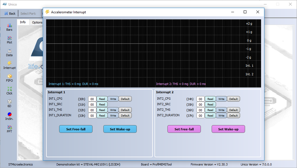

​I am working with STEVAL-MKI109V3 and STEVAL-MKI180V1 (Lis3d). After finally getting the drivers and firmware etc. sorted so that the device is recognised by Unico, it seems now that Unico is not showing the complete set of tools: in particular I am missing the interrupt tool. Any ideas on how to get this to show up? I am attaching a screenshot of my Unico - note that the interrupt (and some other tools) are missing on the left hand side.
Unico GUI Version 7.0.0.0
Firmware Version V2.30.3

The interrupts are not supported in current version of Unico.
Interrupt window is usually used for threshold interrupt, free fall detection, ... these features are not available in LIS3DHH so this window is not available in Unico.

The interrupts on LIS3DHH work fine, you can use them.
The Unico doesn't offer you dedicated window (with settings and chart for INT pin status) for this sensor, because it is not supported so far (in Unico software), but you can configure the interrupts in register map and check the status for example using the LEDs on the STEVAL-MKI109V3 board.
For LIS3DH Unico offers dedicated window for interrupts, see picture below:

Hi Miroslav,
thanks for your reply - I got the MKI105V1 now, and can set the interrupt registers in Unico. that was the easiest option, I think ;)
