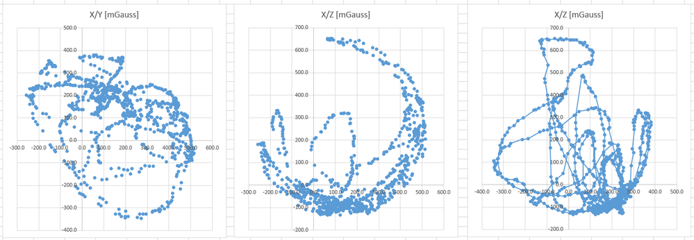

I'm trying to use the MotionFX library with the LSM9DS1. I can initialise the library and I start to send updates using the MotionFX_MagCal_run method then I get the params with MotionFX_MagCal_getParams but the cal_quality is always 0, I tried multiple times. Also, I double checked that I set the sample time and timestamp correctly.
Not sure what I'm missing, is there any way to debug the behaviour of the library?

Here's the magnetometer data that I send using the MotionMC_Update function:
https://gist.github.com/gpgabriel/c0f55be9f32c0d548629d0525e79450e
The data above is calculated as follows:
calcMag(mx) * 1000 * FROM_MGAUSS_TO_UT50
where calcMag returns Gs.
I'm still blocked in the MFX_MAGCALUNKNOWN state. I'll try to add a video with an actual plot asap.
Posted on February 26, 2018 at 15:28
Here's a scatterplot with the data:
https://www.youtube.com/watch?v=sUYUVuT1m_0
blue: xy; pink: xz; yellow: yz
PS. It's not exactly the same data as the one from the gist but it was produced in the same conditions. The values from the video are multiplied with 1000.
Posted on February 26, 2018 at 17:11
Your data seems OK to me.
