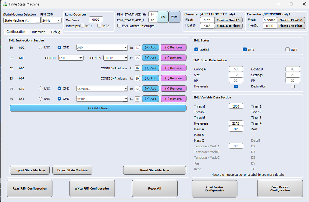

I'm trying to move Finite State Machine config from devkit using Unico GUI to final application. I've prepared movement wakeup example from FSM datasheet in Unico, which is working totally fine on devkit, it could even detect knocking in desk.
static const uint8_t lsm6dso32_prg_wakeup[] = {
    0x50, 0x40, 0x12, 0x20, 0x0C, 0x0D,
    0x00, 0x38, // threshold (1.00)
    0xAE, 0x23, // hyst (0.03)
    0x02, //mask A
    0x02, //temp mask A
    0x41,
    0x75,
    0x10,
    0x10,
    0x22,
    0x00

Overall, it doesn't seem to be working, code below gives me infinite interrupts on INT1. So far I discovered on devkit, it happens when fsm is correctly enabled but there is issue in fsm program. It also happens when I comment lsm6dso32_ln_pg_write.

 Instead of lsm6dso32_ln_pg_write, I've tried to save FSM program byte by byte.
	ret = lsm6dso32_ln_pg_write_byte(&lsm6Context, 0x0400, 0x50);
	ret = lsm6dso32_ln_pg_write_byte(&lsm6Context, 0x0400, 0x40);
	ret = lsm6dso32_ln_pg_write_byte(&lsm6Context, 0x0400, 0x12);
	ret = lsm6dso32_ln_pg_write_byte(&lsm6Context, 0x0400, 0x20);
	ret = lsm6dso32_ln_pg_write_byte(&lsm6Context, 0x0400, 0x0C);
	ret = lsm6dso32_ln_pg_write_byte(&lsm6Context, 0x0400, 0x0D);
	ret = lsm6dso32_ln_pg_write_byte(&lsm6Context, 0x0400, 0x00); //thr
	ret = lsm6dso32_ln_pg_write_byte(&lsm6Context, 0x0400, 0x38); //thr
	ret = lsm6dso32_ln_pg_write_byte(&lsm6Context, 0x0400, 0xAE); //hyst
	ret = lsm6dso32_ln_pg_write_byte(&lsm6Context, 0x0400, 0x23); //hyst
	ret = lsm6dso32_ln_pg_write_byte(&lsm6Context, 0x0400, 0x02);
	ret = lsm6dso32_ln_pg_write_byte(&lsm6Context, 0x0400, 0x41);
	ret = lsm6dso32_ln_pg_write_byte(&lsm6Context, 0x0400, 0x75);
	ret = lsm6dso32_ln_pg_write_byte(&lsm6Context, 0x0400, 0x10);
	ret = lsm6dso32_ln_pg_write_byte(&lsm6Context, 0x0400, 0x22);
And it seems that it was programmed correctly, however it doesn't bring me any interrupts. When I try to break it, for example commenting last 2 bytes, I get the same infinite interrupts behavior as I mentioned in the beginning.
What other cause could there be for the fsm not working properly?

I probably found issue in ST library (lsm6dso32_reg.c). Function:
int32_t lsm6dso32_ln_pg_write(stmdev_ctx_t *ctx, uint16_t address,
                              uint8_t *buf, uint8_t len)
Writes first byte in correct address, but next one finds page wrap (1666-1681 lines):
      lsb = (uint8_t)address & 0xFFU;
    for (i = 0; ((i < len) && (ret == 0)); i++)
      ret = lsm6dso32_write_reg(ctx, LSM6DSO32_PAGE_VALUE, &buf[i], 1);
      /* Check if page wrap */
      if ((lsb == 0x00U) && (ret == 0))
        lsb++;
        msb++;
        ret = lsm6dso32_read_reg(ctx, LSM6DSO32_PAGE_SEL,
                                 (uint8_t *)&page_sel, 1);
        if (ret == 0)
          page_sel.page_sel = msb;
          page_sel.not_used_01 = 1;
          ret = lsm6dso32_write_reg(ctx, LSM6DSO32_PAGE_SEL,
Which results in writting next bytes to next page - so FSM can't find it as it looks at 0x0400 page. Implementation of page wrap is lsm6dso is a little different and it doesn't happen there:
      ret = lsm6dso_write_reg(ctx, LSM6DSO_PAGE_VALUE, &buf[i], 1);
      addr_pointed++;
      if (((addr_pointed % 0x0100U) == 0x00U) && (ret == 0))
        ret = lsm6dso_read_reg(ctx, LSM6DSO_PAGE_SEL, (uint8_t *)&page_sel, 1);
        if (ret == 0)
          page_sel.page_sel = ((uint8_t)(addr_pointed >> 8) & 0x0FU);
          ret = lsm6dso_write_reg(ctx, LSM6DSO_PAGE_SEL,
Is this a bug and if not why has it been implemented in this way?
