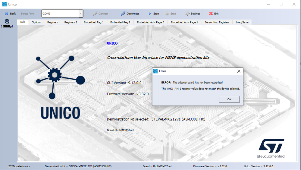

Dear ST Community,
Ten days ago I already asked this support request but no one single response came from ST.

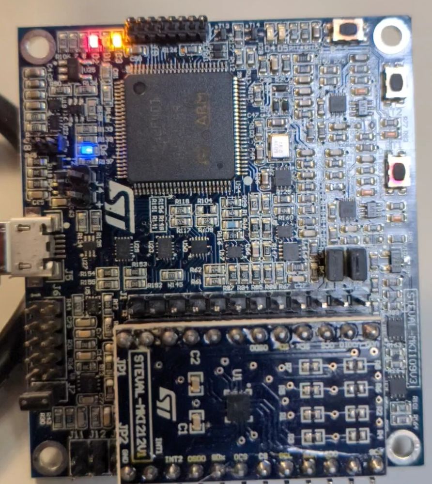

I just bought and received an ST-EVALMKI109V3 + ST-EVAL212V1 after attending the webinar "Develop effective AI solutions for monitoring vehicles using a single sensor".
I get this error that says it does not know the chip id when I select the MKI212V1 as shown in the screenshot above.
All my software tools seem to be on the latest revisions. Anyway I updated the board with the last firmware using this video : Same issue.
I also joined
Could anyone help me please on this? Buying more than 100€ for 2 non-functional boards is already frustrating. Receiving no help is even more frustrating. Do you believe it lives up to the image of ST-Microelectronics ?

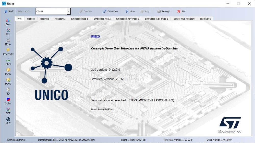

2022-09-29 06:44 AM
-solved issue-
With no change at all on my PC Software Tool Unico, it worked at first start with the boards you sent me.
My issue likely came from the one I bought that was not functional.

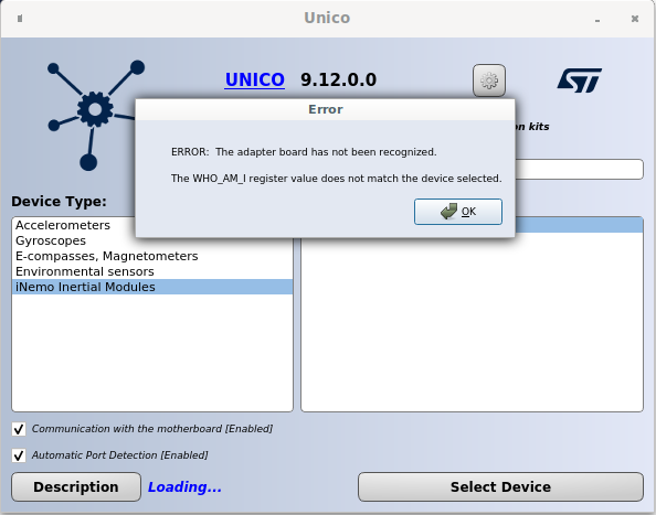

(1) We did it using a freshly downloaded Linux install from ST website. The Linux distribution is Debian Buster on AMD64. We got similar error as show below:

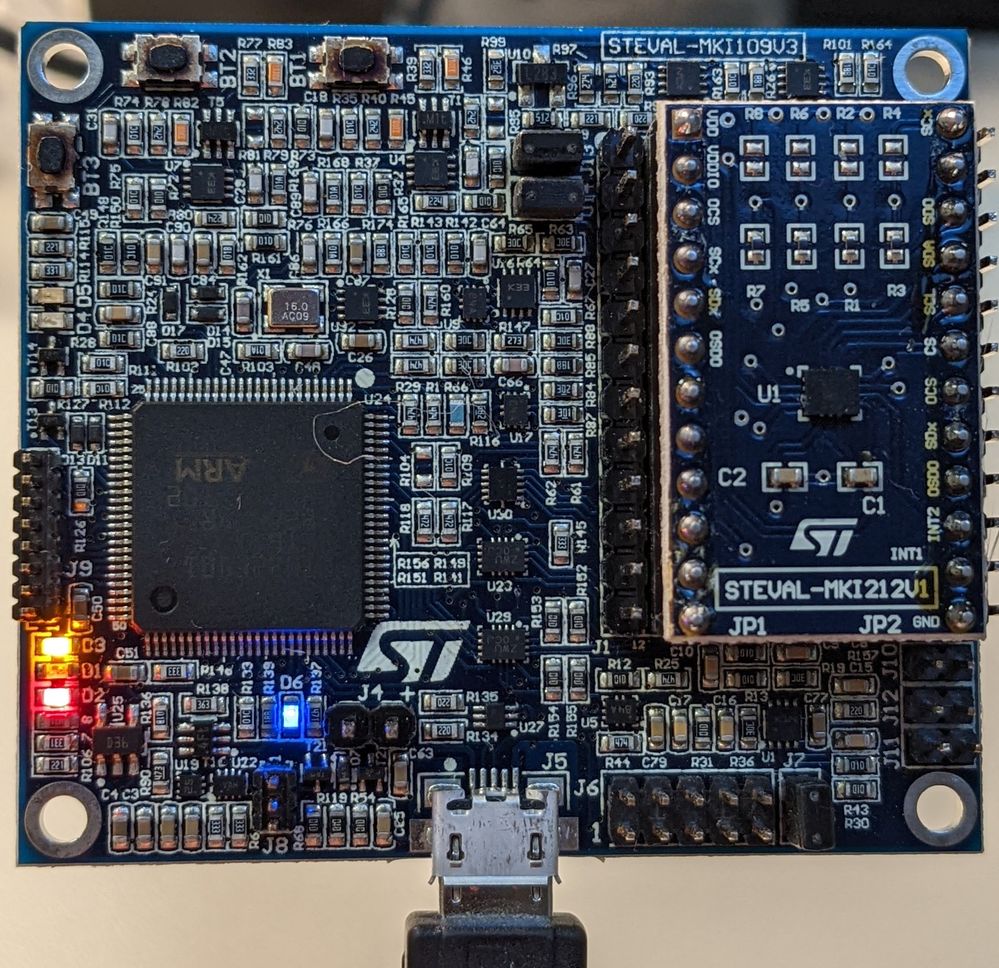

Here is also a picture of the STEVAL-MKI109V3 board where we see some LEDs solid. This could help you?
(2) We do not have any other adapter to do the test you suggested. We are far not ready to buy another STEVAL-MKI212V1 clearly by lack of confidence of ST evaluation board quality...

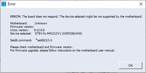

Maybe this could help you : When I double-click on "iNemo Inertial Modules | STEVAL-MKI212V1 (ASM2330LHHX)": I got this error that details a certain command "setdb212V1" that fails:
Hope reading from you soon.
Best regards
Thierry
2022-08-05 05:39 AM
Hi Thierry @tlamotte9 ,
Unfortunately we are running out of suggestions, other than to try with another steval adapter.
By the way, we can send you a working Profi + new adapter, tested in ST: you can send your shipment address via private message (top right of this page).
-Eleon
2022-09-29 06:44 AM
-solved issue-
