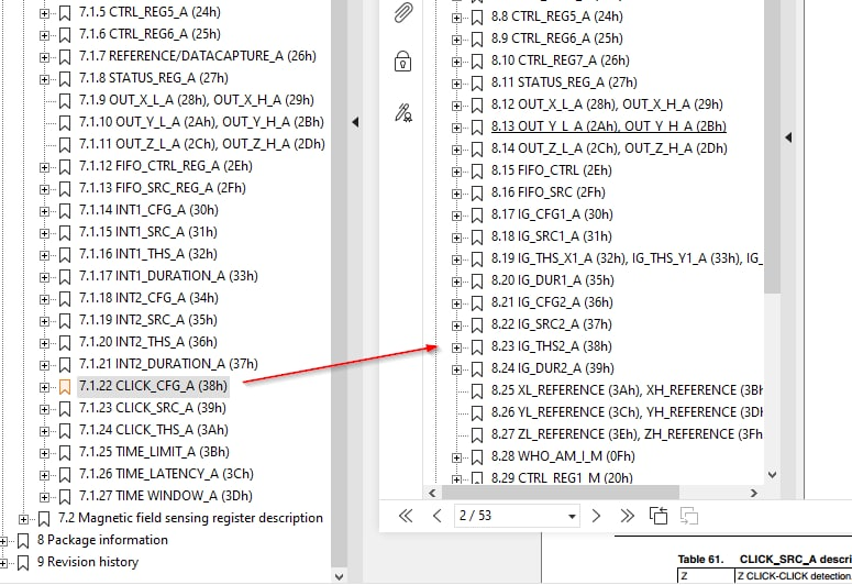

LSM303DLH has CLICK register to setup it but LSM303C has only commont THS and DUR registers set, can I use it to detect single tap event?
As I understand I can setup AND config for all axis, but it doesnt work so good and I can get false detection for some angels of device

My aproach is right? Is possible to do it on LSM303C ?
*my ODR is 100Hz
Note: I already use inactivity resicters, therefore for tap detection I have only INT1 or INT2 events
INT2 also used for freeFall detection

Hi @Denis Krasutski​ ,
First, I suggest you not to use the LSM303C product, since it is obsolete.
You might try to change the duration of, and/or to activate the High-pass filter in the CTRL_REG2_A (21h) register.
