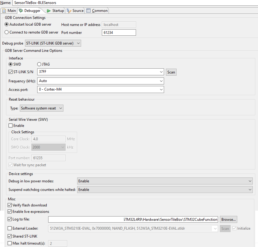

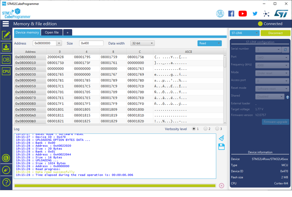

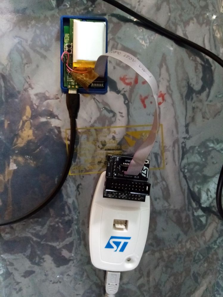

Am trying to connect SensorTile Box Using St-Link to flash the Program. But When I connect in DFU mode "USB" is getting detected, but through ST-Link V2, the serial numbers getting detected but am not able to connect. It says "STM32 Target not found".
I have attached 2 images for ref. Please confirm which connections are correct.
Image 1- I have connected the St-Link with Jtag in the Adapter.

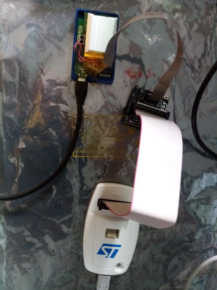

Image 2- I have attached the adapter directly into the St-Link.

BHadj.1
Hi, two screens shots to be shared for an IDE setup and CubeProg. Please check.
