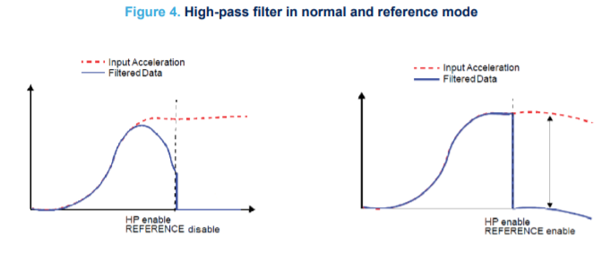

Hi Maya @Msaga.1​ ,
you might be then interested in the application note AN5038, p. 12:
The high-pass filter can be configured in reference mode by setting the HP_REF_MODE bit in the CTRL7 register to 1. In this configuration the output data is calculated as the difference between the measured acceleration and the output values captured when reference mode was enabled. In this way only the difference is applied without any filtering.
This picture is probably mote explicative:
0693W00000AN0fjQAD.pngAn example related to the wake up feature is then explained:
This feature can be combined with the wake-up functionality described in Section 5.4 in order to detect when the device is displaced with respect to a specific orientation, i.e. the orientation of the device when the HP_REF_MODE bit was set to 1. When the output acceleration exceeds the wake-up threshold defined by the WK_THS[5:0] bits in the WAKE_UP_THS register for a duration longer than the one defined by the WAKE_DUR[1:0] bits in the WAKE_UP_DUR register, an interrupt is generated. If the device is moved back to the original reference orientation, the interrupt is deactivated.

Hi @Msaga.1​ ,
the difference between the two "high pass filter modes" (i.e. with reference mode enabled and disabled) are depicted in the figure above:
  • Case high-pass filter reference mode disabled (default): the output signal is filtered from the DC component and from the slow varying components up to the HP cut-off frequency (according to the configuration of the CTRL6 (25h), datasheet p.42);
  • Case high-pass filter reference mode enabled: the DC component is removed with reference to the moment in which this configuration has been enabled, but the slow variation in the acceleration are still there; you can use this configuration when the signal you want to detect is at very low frequency but not constant in time. In particular, this mode uses the Reference block depicted in the block diagram of the datasheet, p.3.
Is it clearer now?
-Eleon
