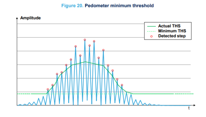

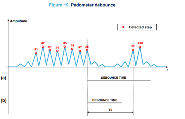

Hi, a pedometer output can sometime be biased by movements that are similar to the step pattern. The accuracy of the device also depend upon the position (wrist or waist, for example). You could vary the main parameters of a pedometer, such as the debouncing in register ****_DEB_REG (14h), the threshold in register CONFIG_****_THS_MIN (0Fh), and the delta STEP_COUNT_DELTA (15h) to tune it for your application and to make it less sensible to other-than-steps movements.
Debouncing parameter
threshold parameter

I increased the threshold all the way to the maximum value (0xFF), the accuracy was reduced by a small factor (8% less steps - I don't mind that) when actually walking. But it didn't make much difference with respect to false steps though. Changing the pedometer de-bounce did not making any difference either.
I am using the sensor on the wrist and ankle to count the steps. I wonder if there is any pre-set values for these register for using it wrist or ankle or hip etc.
